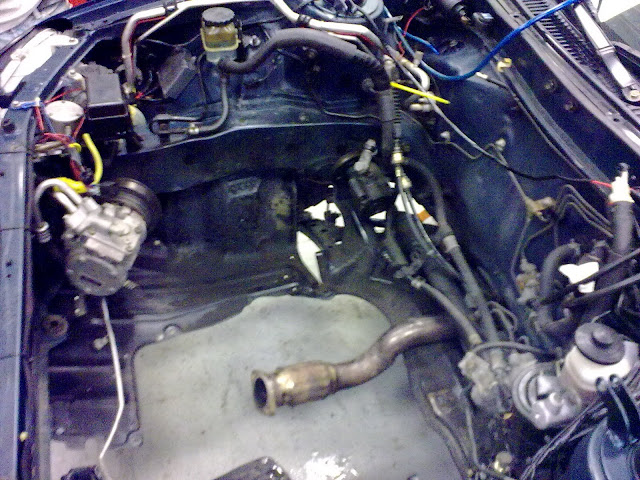

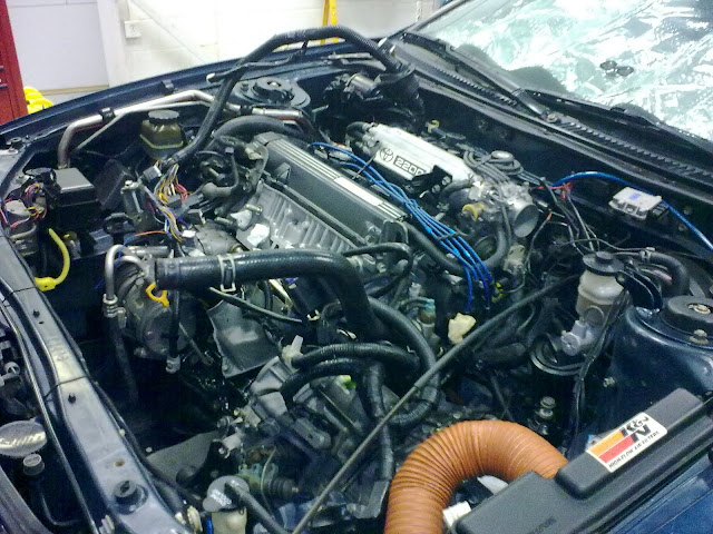

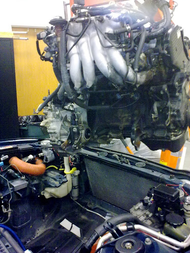

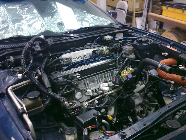

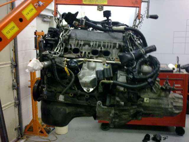

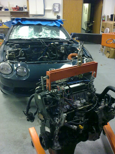

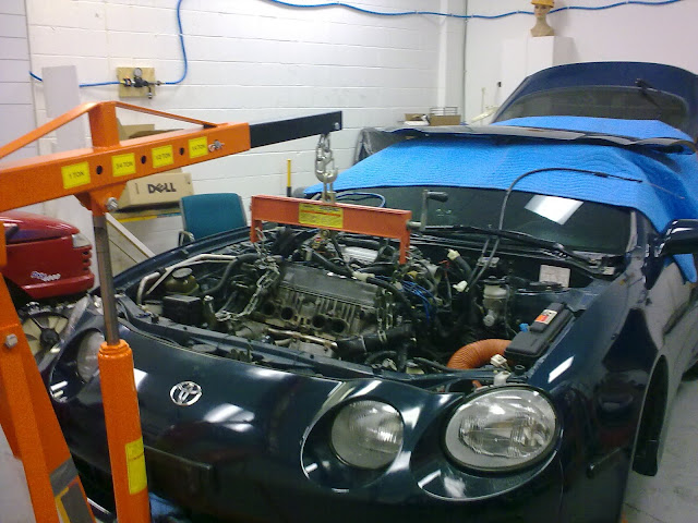

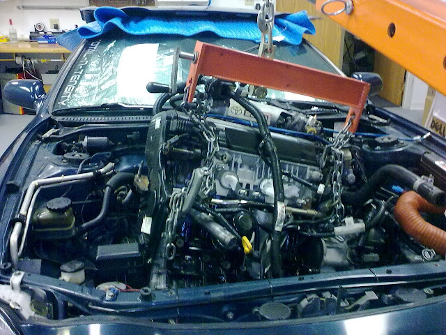

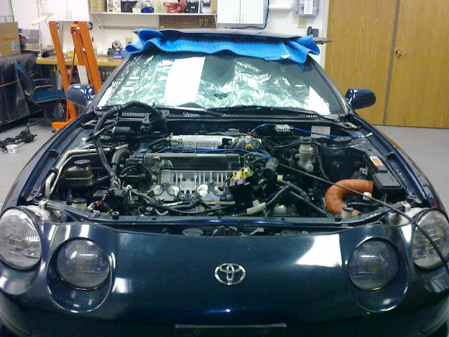

Well underway to taking the old tired engine out

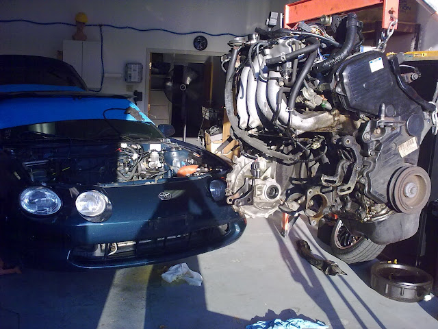

Here it comes... (thats what she said?)
Almost out

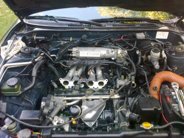

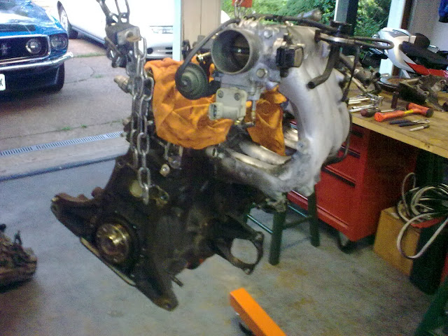

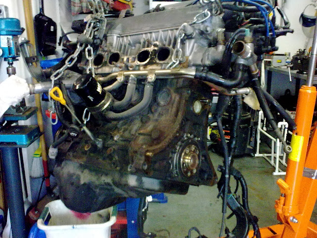

Needs a little cleaning...
And here is the culprit for wayy too many speeding tickets.
To be reunited soon
Whiteboy power? (My buddy, not me)
It was definitely time it came out for a good clean if anything!

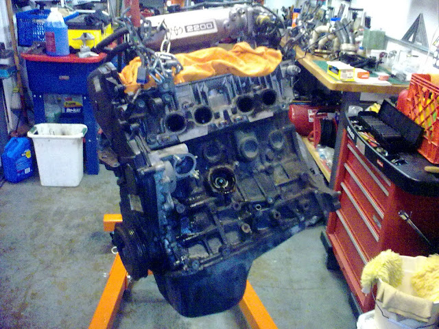

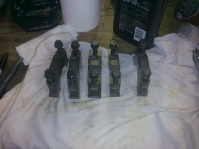

Tear down
organization is key in a good motor build.

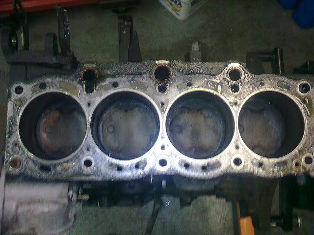

Finally popped the top
260K miles worth of carbon...not too bad i guess.

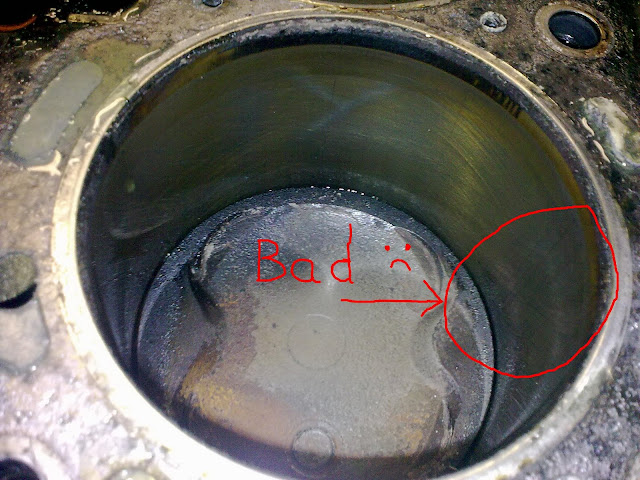

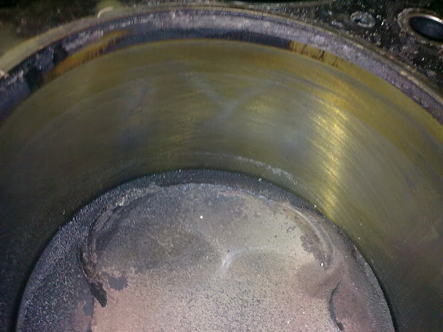

Factory honing hatch marks?! Wait a minute here...
I knew it was too good to be true...bores are totally worthless and scratched up on the sides,
sorry it may be hard to see in this picture but it was there in all 4! frown.gif

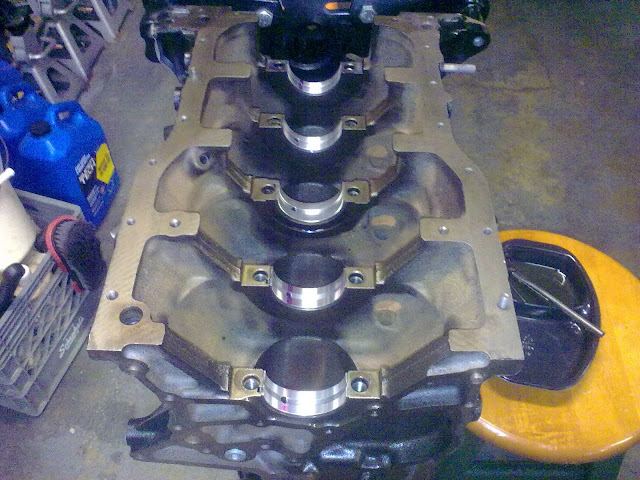

Bare block ready to see the machine shop.
At this point I brought the block, head, cams, flywheel, crank, rods, pistons, and crank pulley to my machine shop to have them check everything and
dynamically balance the entire rotating assembly.

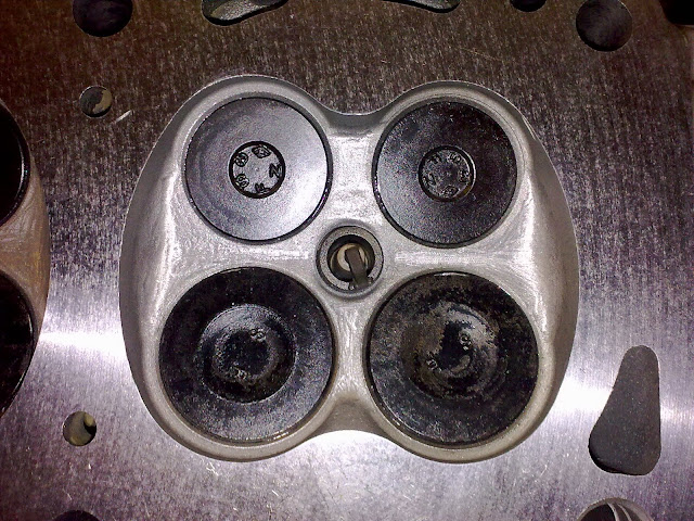

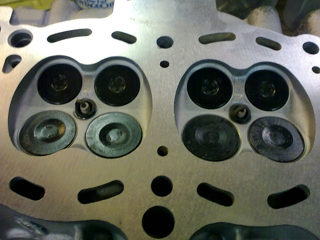

Hard to see, but the head was cracked in about 7-9 different places, I never would have know
if I had not taken it apart, this thing ran like a beast!

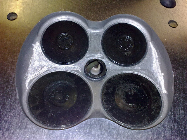

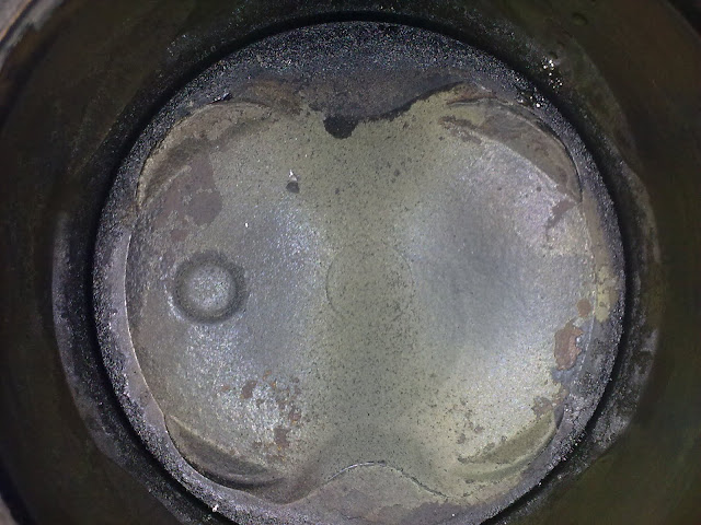

This picture shows what happens when a spark plug electrode tip breaks off and rattles around your motor for a while,
car still ran perfectly with this damage, the top of the piston looked the same as the head.
Machine shop also pointed out that the motor was running hot, hence the imprint of the head gasket around each combustion chamber...

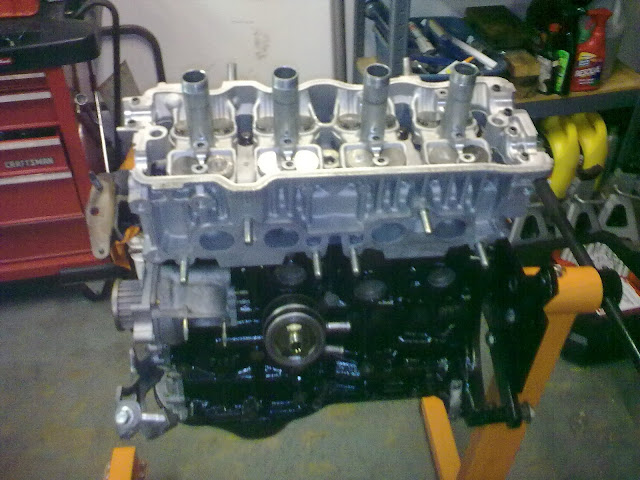

After about 3 weeks of waiting on one piston, finally got everything to the machine shop and got it all back. Work done includes:
- Block bored .20 over
- Block decked to ensure flat surface
- Balanced crankshaft, rods, pistons, flywheel, and crank pulley.
- Polished cam bearing surfaces
- Shot-peened rods to recondition and strengthen
- Cleaned block, intake manifold, and all other items at the machine shop.

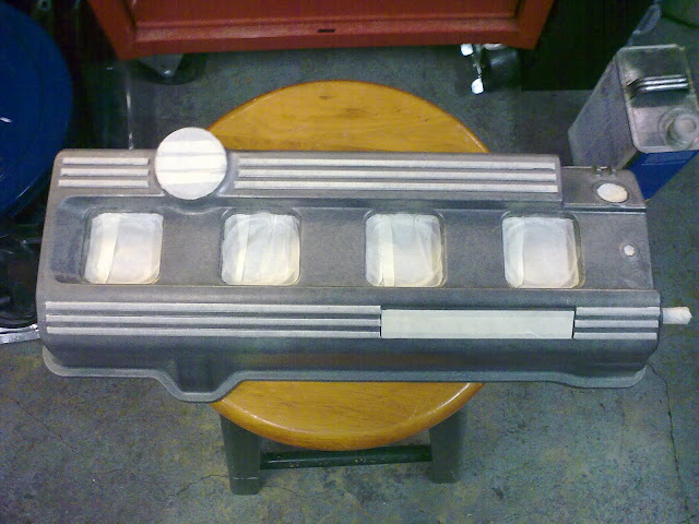

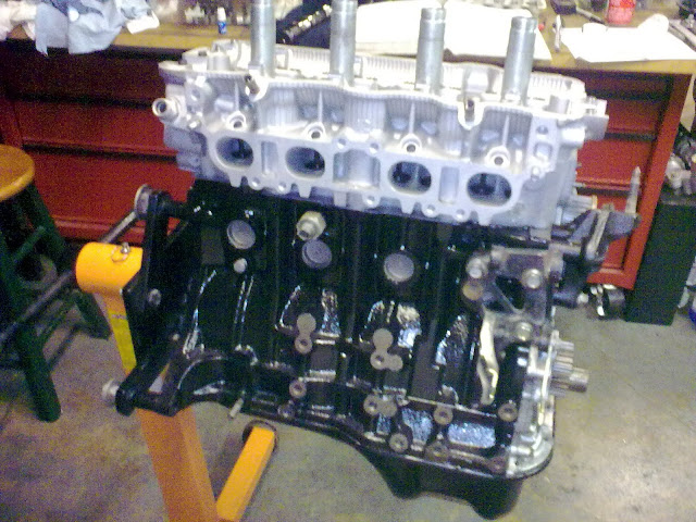

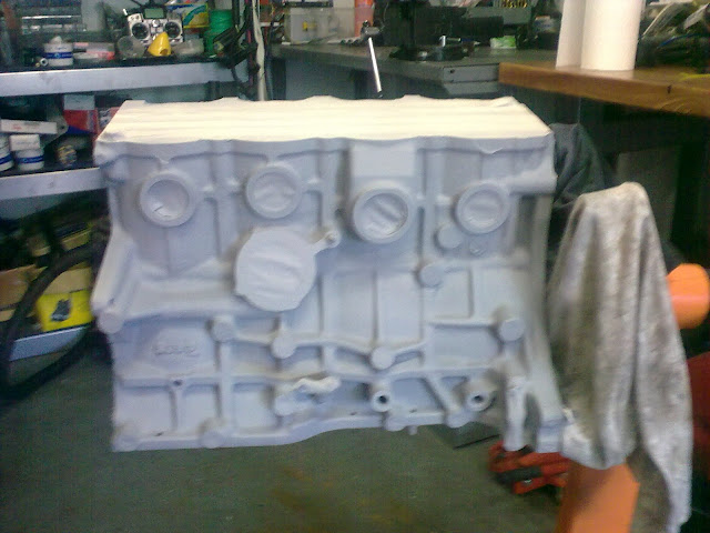

Masked off the blocked and primed it
Same treatment for the valve cover

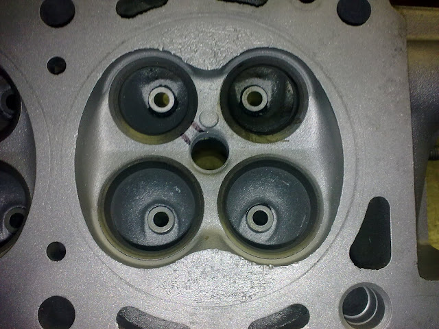

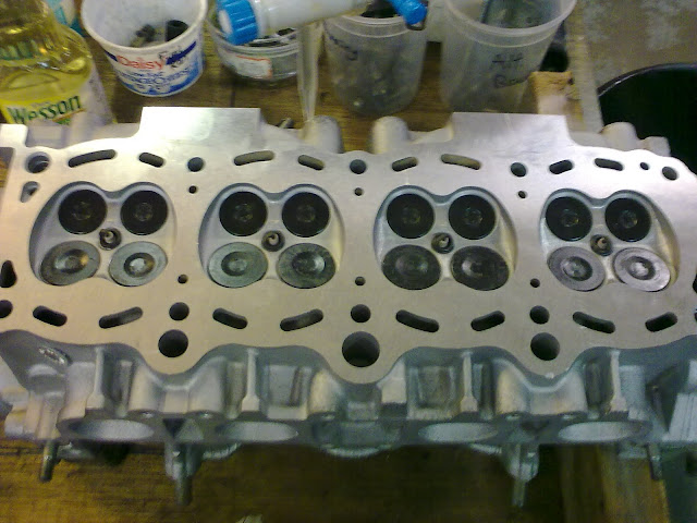

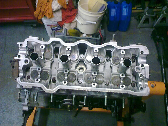

Re-man cylinder head gets a combustion chamber balancing
Finally got all 4 combustion chambers to have the same volume within .05 cc
Painstaking process but entirely necessary especially for the upcoming power-adder.

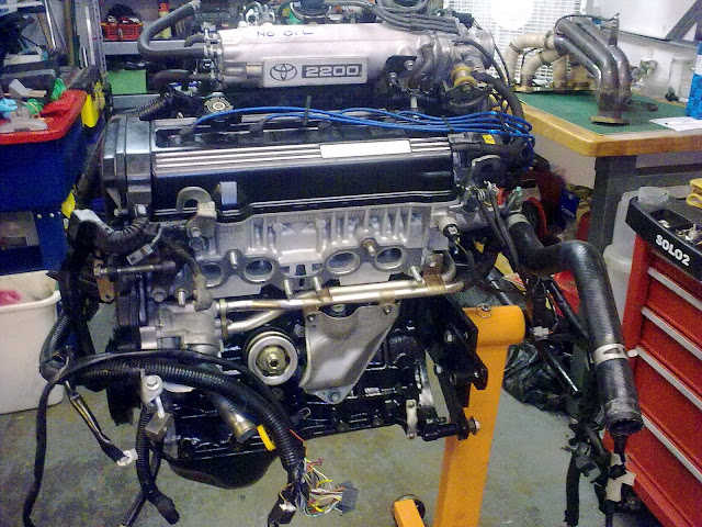

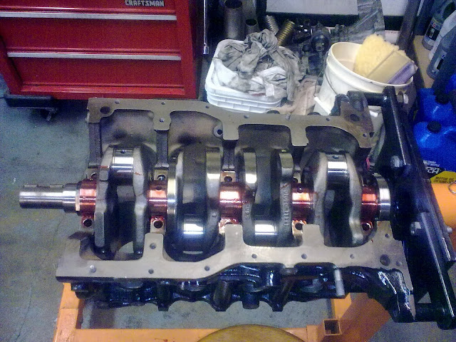

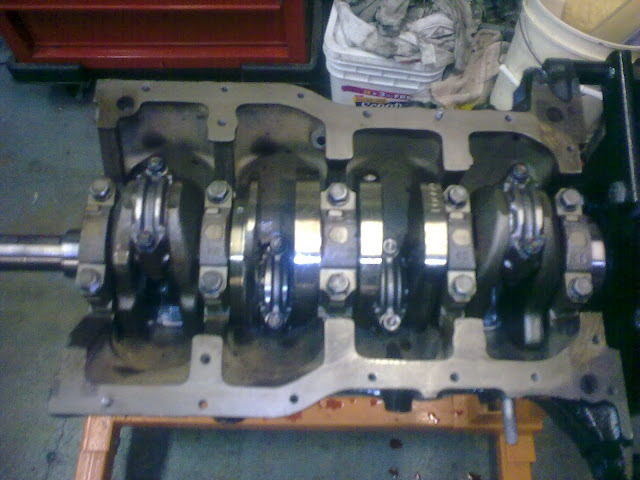

And the reassembly begins:
Now I would like to say that i'm good enough to do this by memory...but I have a little cheat cheat wink.gif

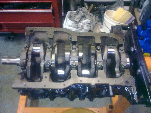

Freshly balanced crank gets dropped in...
And bolted down.

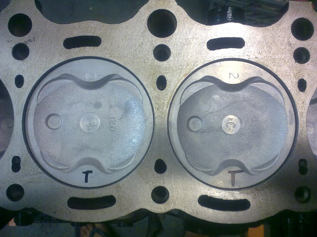

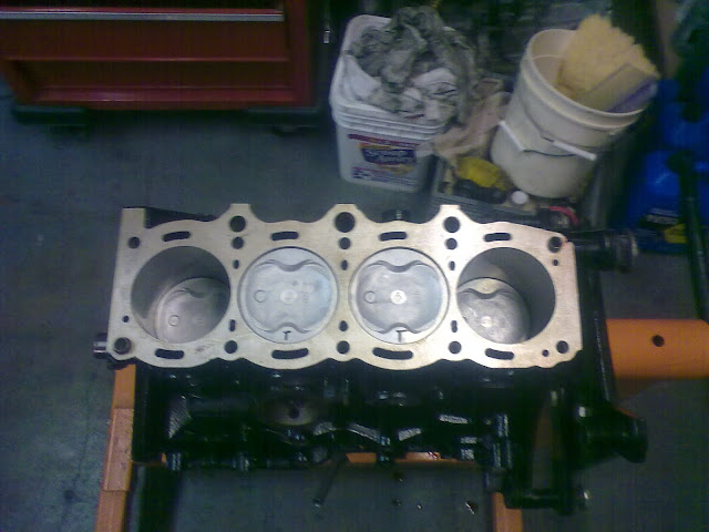

Everything looks so clean...
By the way, I painted the block and valve cover in a fresh Gloss Black...and the new head it on and torqued.
Needs 294's!!!!...soon to come
Oil pump and new water pump installed

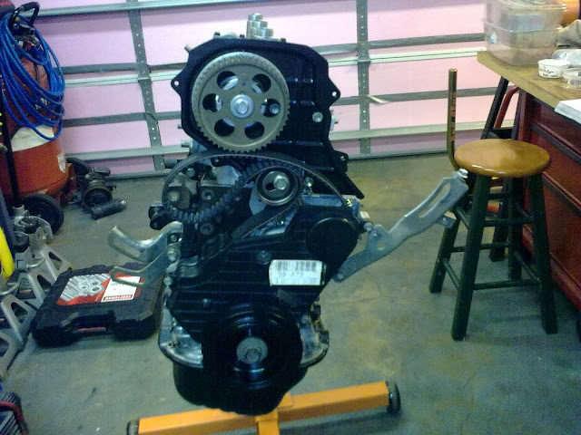

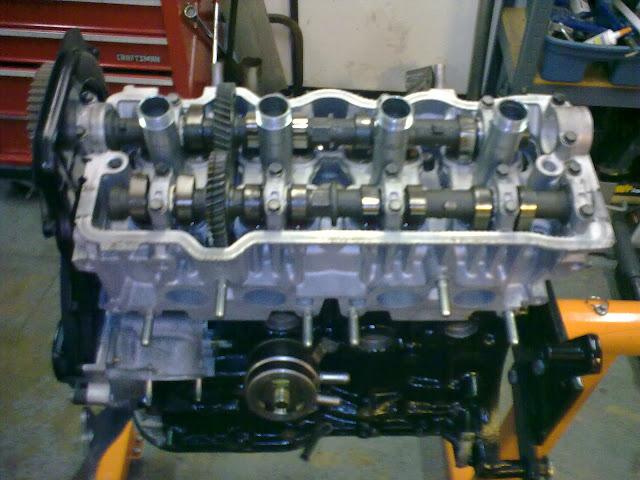

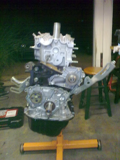

This thing is so much easier to time out of the car....
Performance cams happily in their new home as well

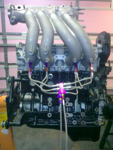

So after some deliberation and thought, I decided to go for a Zex Direct Port Injection Wet nitrous kit, this would ensure that all cylinders will get the same amount of nitrous and fuel and reduce my chances of leaning out one or more of the cylinders. The main reason I did this instead of the easier alternative of just spraying through the throttle body is because I asked the 6gc community which one they would recommend, and I got some great answers from many members. The one that really pushed me to go the direct port route is that from Dr. tweak (Thanks). he stated that the FI intake manifold is designed to flow air and not nitrous and fuel, so there is a great chance that the first 2 or 3 cylinders would be properly fed, but the last one (#1) would get the least amount of fuel, and lean out and possibly crack a piston or maybe even worse.
So after this I decided, ok if i'm gonna do this I am going to do it the right way, and that is why I chose this set up. Also because I dont think anyone else has done a setup like this on a 5S which means I get to enjoy the trials and tribulations of trying it out...oh boy what am I getting myself into!?!?!
So with no nitrous experience before I set off into a new world..for me:

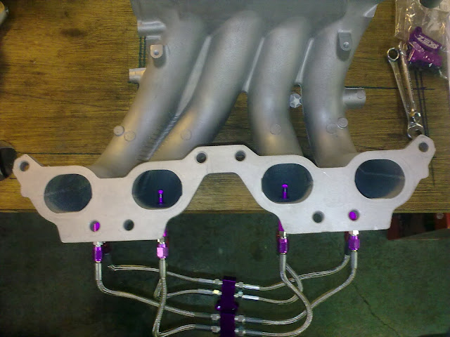

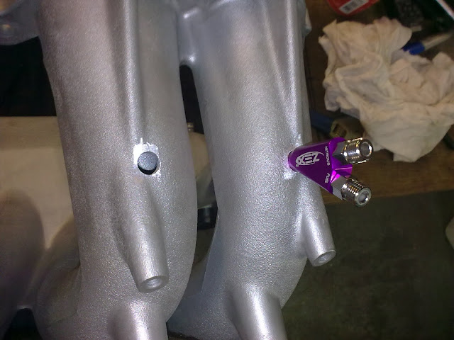

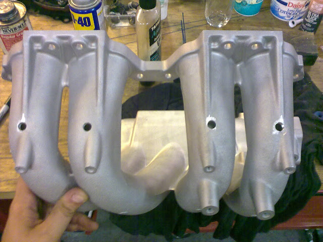

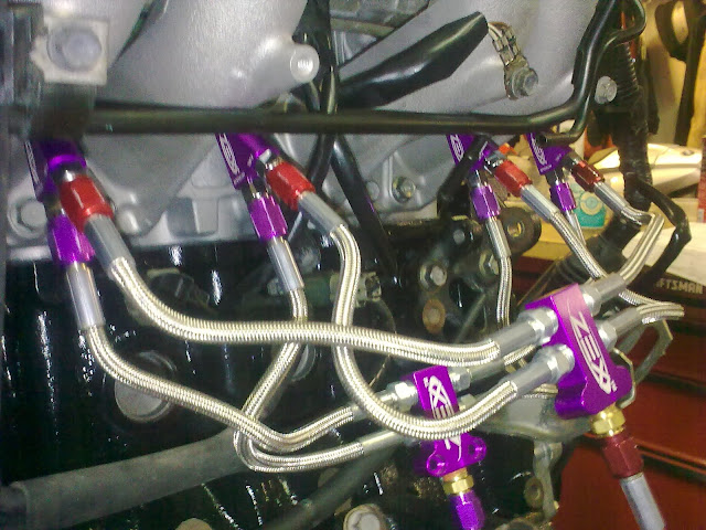

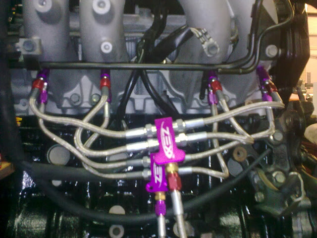

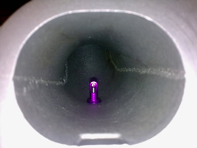

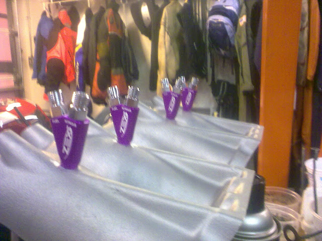

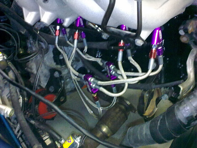

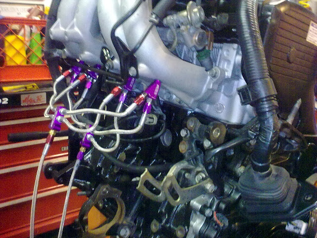

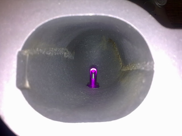

Drilled 4 holes in the bottom of the intake manifold to fit some pretty purple pieces
Like these!
Shiny!!! 8O
Inside shot of the intake runner
Another shot of the same

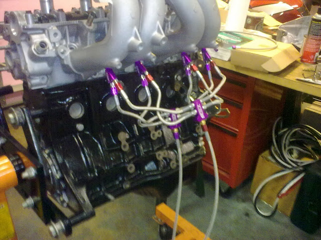

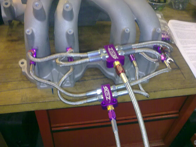

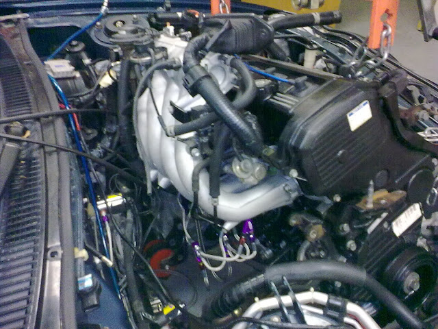

Starting to take shape
Holy crap!!! Is this really happening?!??
Test fitting to see if it all drops on....
Hot damn! I barely cleared a part of the air pipe on the back of the manifold for cylinder #2...but it works!
Here you can see where the nitrous nozzle is snugly against the air pipe on the right...
I must admit, it looks bad-ass!

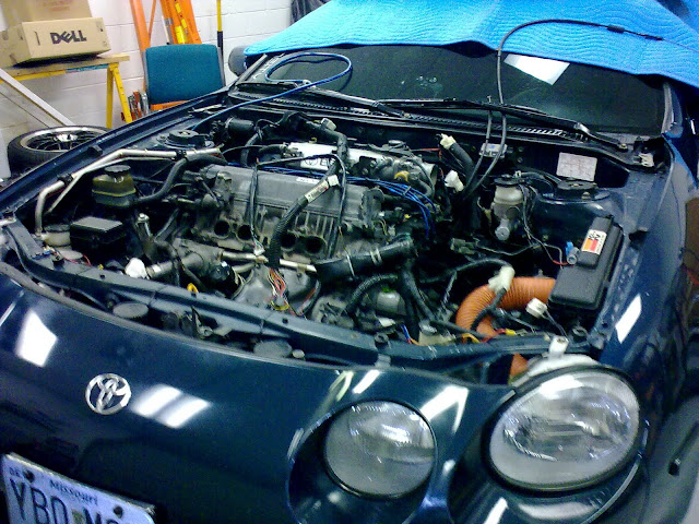

Finally she is all back together...just putting the finishing touches on.
Another close up for SnGs

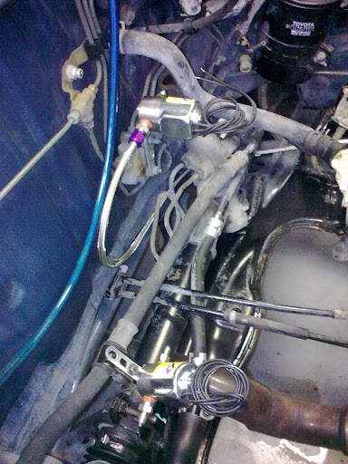

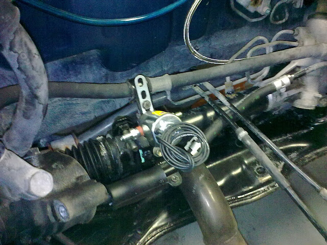

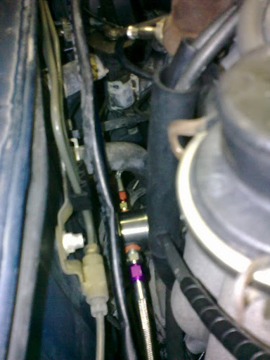

Find the nitrous solenoids... ok its not that hard.
Nitrous solenoid...not drilling required to mount it.
Same goes for the fuel solenoid.
And a shot of both

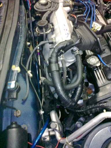

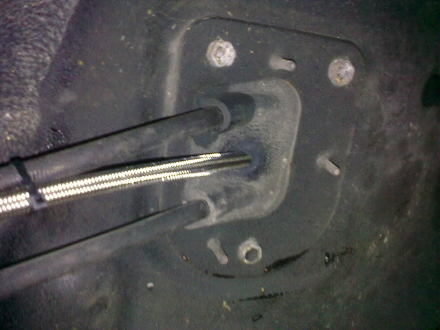

Ran the supply line for the bottle trough the shifter cables boot, water tight, and secured to the shifter cables so its not going anywhere.
Just a shot to help locate the solenoids

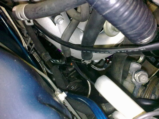

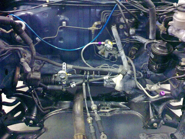

As far as clearance issues are concerned, this thing fit like it was meant to be! I couldnt believe it when I saw it!!!!
Almost in
Another shot of the lines, hard to tell but it all cleared the exhaust, the steering rack, and the K-member without needing to be repositioned...all luck! I mean skill *cough*
Holy crap! Where did it all go?!?

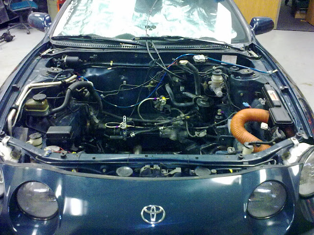

And she is all back at home, just need to button it all up and try a first start
At this point I finished up plugging everything back in, primed the motor and turned it over, it actually suprised the hell out of me and started right up on the first turn of the key, I must have done something right at least!
The only thing left to do for the nitrous kit is to wire up the solenoids and the activation switch, the WOT switch is already on the motor, just need to do the arming switch and mount the bottle.

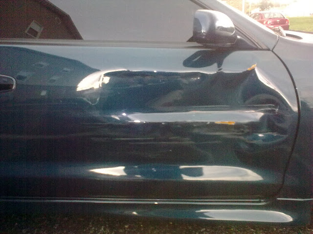

Took out my entire passenger door, luckily the damage was limited to the door only, not the fender, not the rear quarter...just the door...a bit of luck I guess.
So regardless I kept driving the car, took care of all the insurance mumbo jumbo and go a settlement check. Then I was on the way home from school one weekend and halfway home...

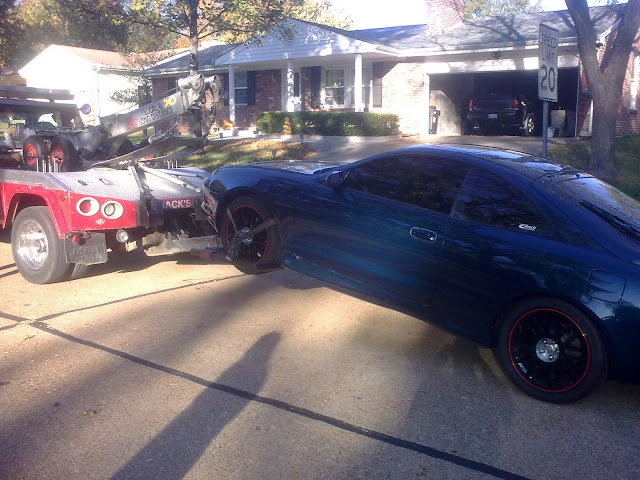

Managed to coax her into an AZ parking lot, changed plugs, distributor cap, rotor and it still continued to fire on only two cylinders...FML
So I called AAA to the rescue
And had her towed 112 miles the rest of the way home, first time I have EVER used AAA for my own car...and it payed off, only cost me $36 in the end! Love AAA!!!!!
