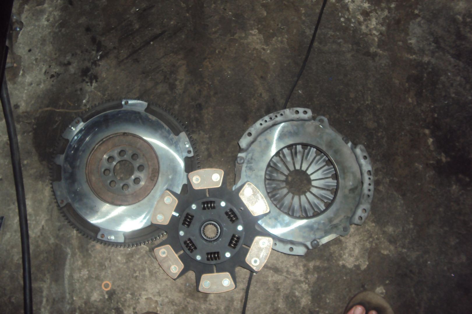

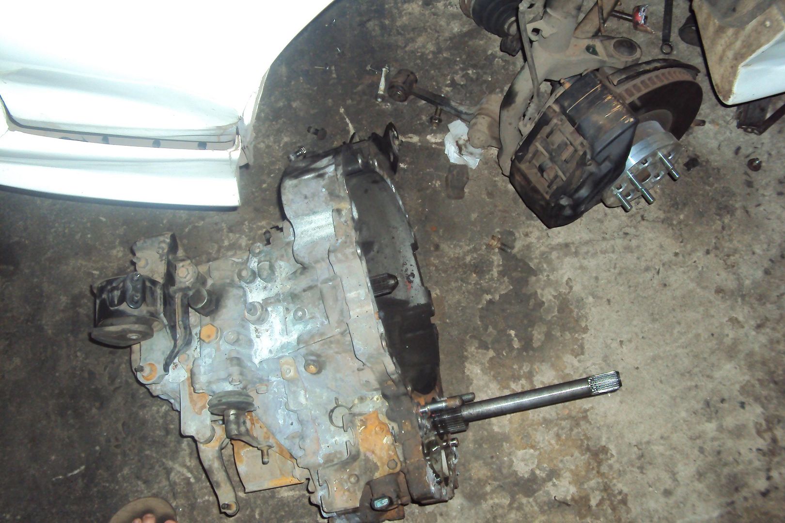

- - Neon90424   Putting in my gearbox has been a major pain in the...   Mar 19, 2011 - 9:19 AM
- - Sunny   Hi, put out the engine is the best way to mount/d...   Mar 20, 2011 - 7:39 AM
