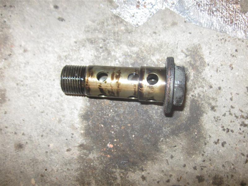

Like I had mentioned earlier, Jim wants to use the complete Gen3 oil system, including the oil cooler, on the 5sgte I'm building.
I know guys have used the Gen3 oil setup on Gen2's before, but I've yet to see a setup where someone used a 5s block, with the Gen3 oil cooler.
One of the problems is that the 3sgte oil cooler mounts to a base with a thru bolt, and the base is mounted to the block with 4 bolts.
The 5s does not use a base, the oil cooler bolts right to the block using the center thru bolt.
After messing with as many 5sfte variations as I did, I am used to messing with the oil coolers and how they mount, so I figured that if the 3s cooler had a rubber seal on the bottom, that was smaller than the outer diameter of the 5s oil cooler boss, than I would just have to figure out the mounting bolt situation.

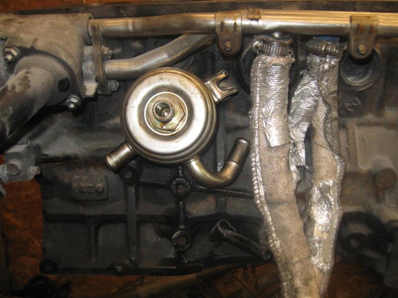

First, a pic smaay posted of the 3rd gen oil cooler in its stock location, you can see the base it is mounted to that bolts to the block. (just like the 2nd gen 3s)

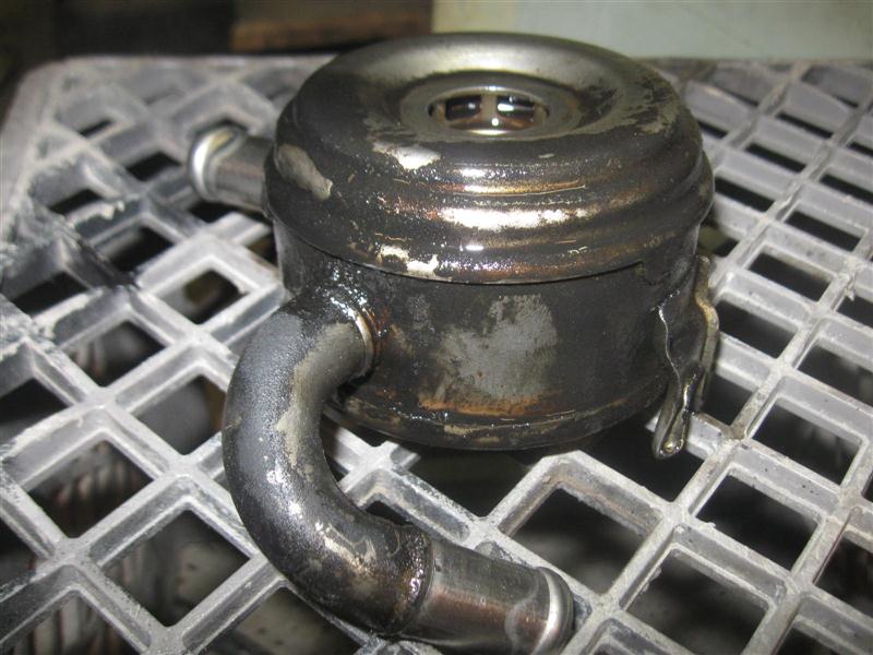

The 3rd gen oil cooler, after i removed it from the 3s block:

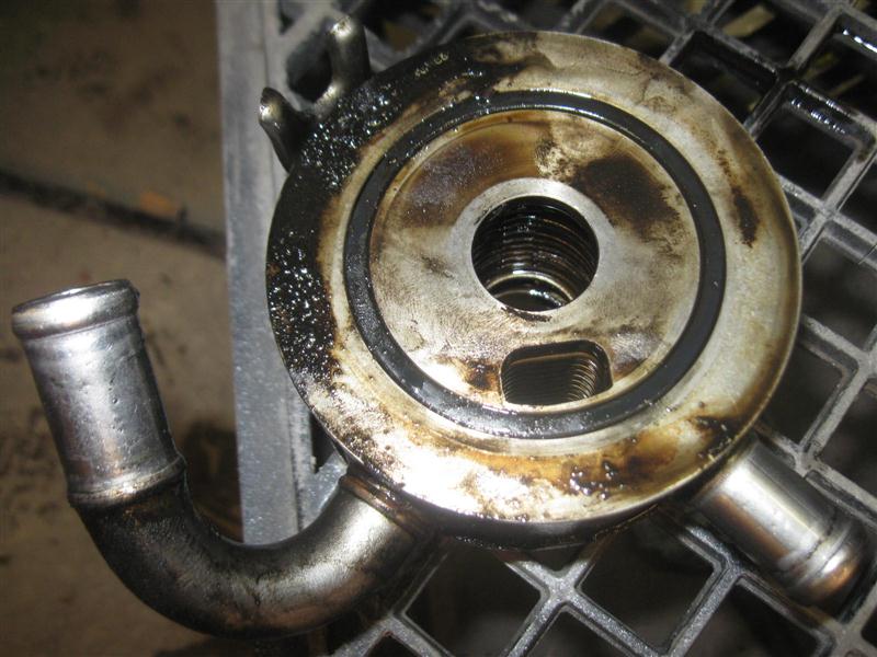

the bottom:
The thru bolt that bolts it in place on the 3s block:
After bending one of the lines for a little more clearance for now, I could sit the oil cooler flush against the 5s block, but the 3s thru bolt is not long enough to reach the threads....So,
the 5s oil cooler thru bolt is longer, but has the mount for the oil filter.
I tried that, and it works perfectly and has the appropriate holes in it to allow the oil cooler to work properly.
once my tig welder arrives, I will cut off the oil filter mount, and fill that with weld.
problem solved!! WOOOOOT! I just KNEW all that time spent messing with the 5sfte's would pay off someday! lol
::EDIT:: The 5s oil cooler bolt will not work. The easy solution is to use a 4th gen oil cooler, and thru bolt. (Its a bolt on deal with the 4th gen parts)

AAAGHHH i cant see the pics from work, stupid filters!!!!! Pressure, Jim, Dr. Tweak, have any of you guys considered not using an oil cooler at all? the 2ZZ does not use an oil cooler. i dont have any issues with my beast driving down the strip. the 7A doesnt have one either. So my big question is, is it really necessary? does the S series generate that much heat that a cooler is needed, or is it just a bling thing?
come to think of it, i took the cooler off on my All-Trac and never had a problem for the short duration i drove the car.

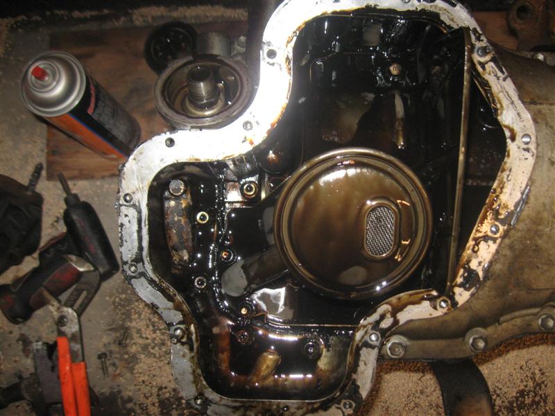

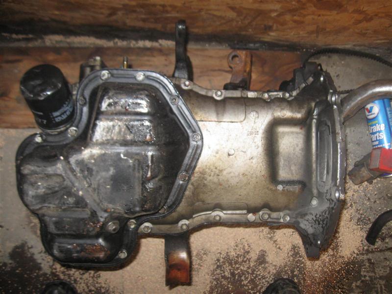

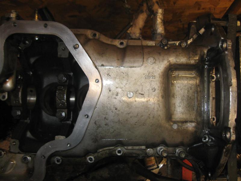

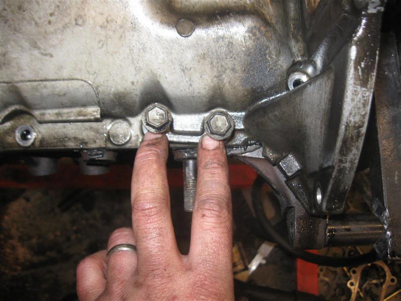

got the 3rd gen pans off the 3rd gen block, and found out what needs to be done to bolt them onto the 5s block.
here are pics.
3rd gen lower and upper oil pan, on the 3rd gen:
with the lower pan removed.
the allen head bolts all have a home on the 5s block.
the studs for the 2 nuts are shorter on the 5s block, so i will use the 3s ones.

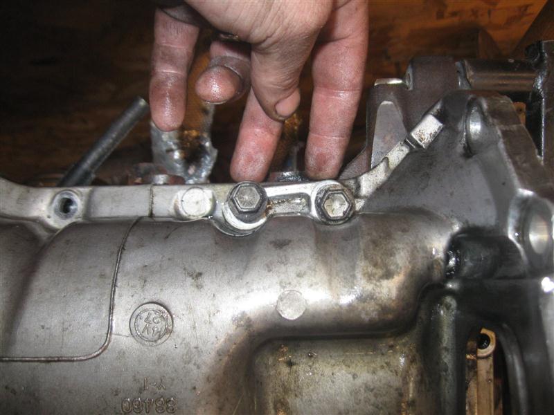

here is the upper pan, layed on the 5s block. the 4 bolts you see are where i need to drill and tap for the 12mm bolts.
the bolt in the right side of the pic has a 10mm bolt hole now, i will just need to enlarge it and re-tap it. the left one will need to be started, drilled and tapped.
same here.

installing squirters in a block that did not have them before is not easy. it can be done if the galleys are there but it also depends on whats feeding them. for example the squirters in the 2ZZ-GE get their oil from the crankshaft. as it rotates around the main bearings it finds the hole in teh bearing and then pushes oil up into the block through the galleys to the squirters. another thing to consider that squirters cause a drop in oil pressure.
when you build a stroked 2ZZ-GE the squirters have to go. i have not had mine for something like 5 years. lots of dyno pulls and lots of miles down the track. no issues here.
they are nice to have but not really necessary.
thanks for the pics Pressure, now the big question is, where can i get the upper and lower oil pan.

2 of the 4 bolts have corresponding holes in the 5s block, but they are for 10mm bolts. I wil drill them out and tap them for the 12mm bolts.
