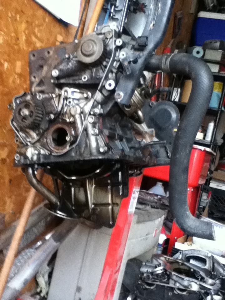

I got the built block up on a stand, and immediately noticed a serious issue with it.
The surface of the block is all pitted, and especially around the bores, like it had been shot with a Shotgun or somthing!
A few pics:
What exactly caused it, I dont know, but what I do know is I definetly wouldnt trust it to seal with a metal headgasket, and I definetly wouldnt want to have the block machined that much to bring it back to flat.

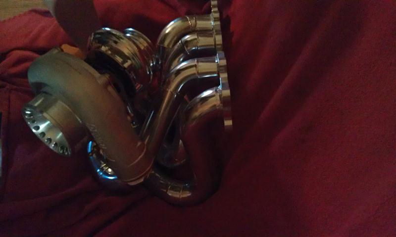

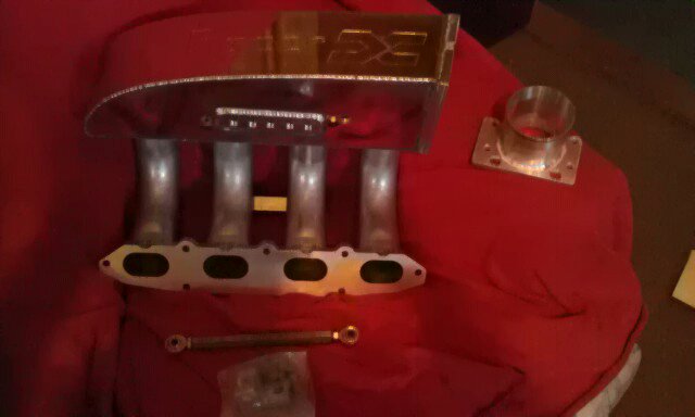

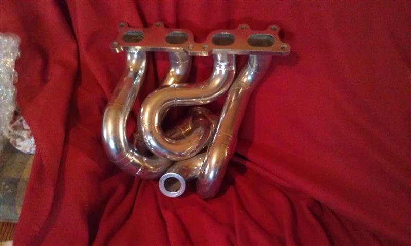

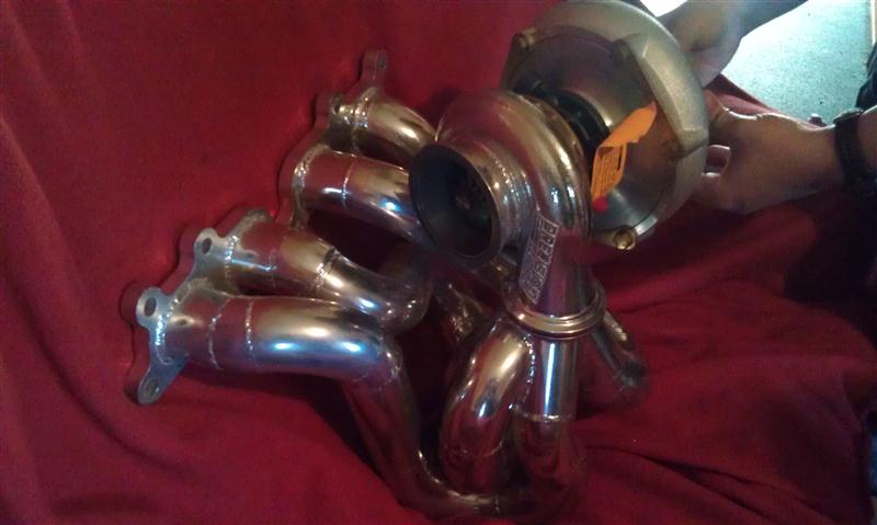

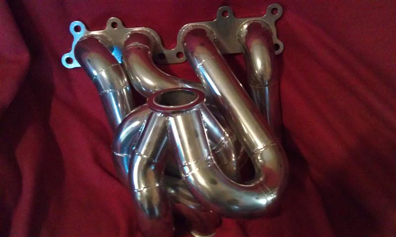

- - presure2   back from the dead!! this week i got a lo...   Aug 27, 2011 - 7:39 AM
- - freddy121389   Omg..... that's the best looking manifold I...   Aug 27, 2011 - 8:42 AM
|- - presure2   QUOTE (freddy121389 @ Aug 27, 2011 - 9...   Aug 27, 2011 - 9:13 AM

- - SwissFerdi   That manifold gives me quite fuzzy feeling. Lookin...   Aug 28, 2011 - 7:55 PM
