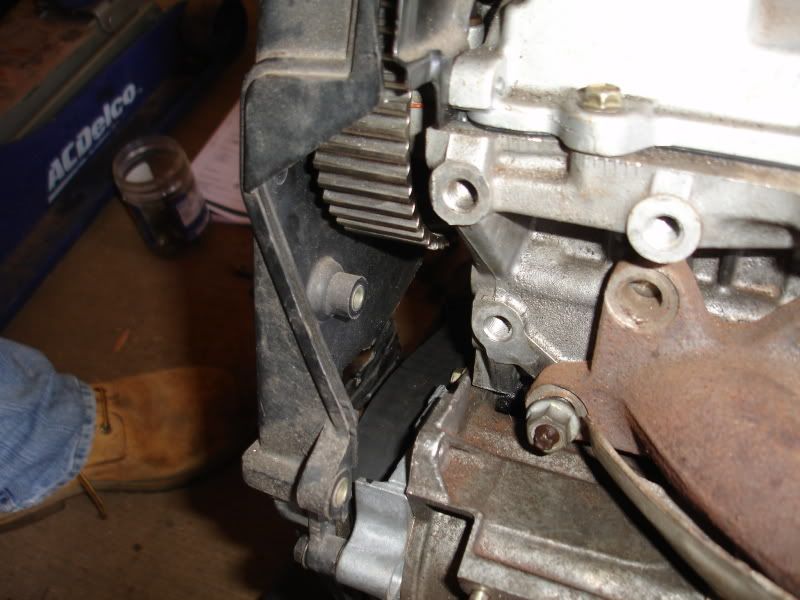

Q2 What goes in this gap in the timing covers? I don't have an alternator bracket yet.

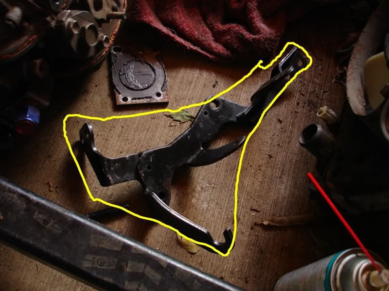

Q3 What bracket is this? It was sent to me from someone a year ago that said it was an alternator bracket, but I can't get it to fit.

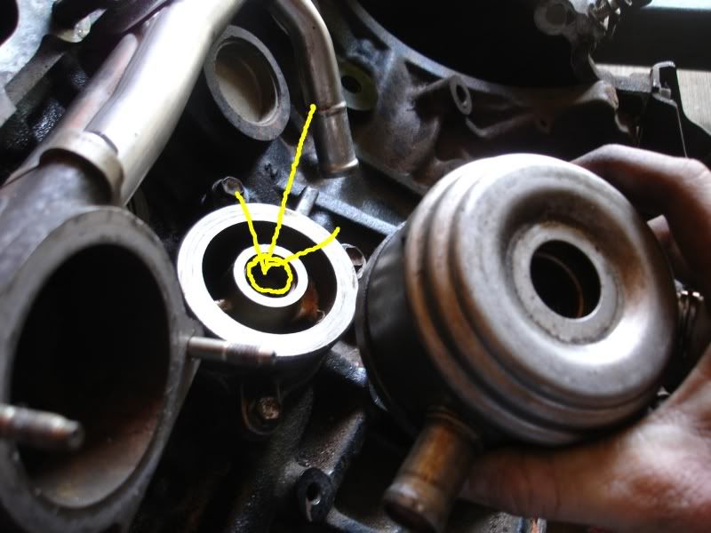

Q4 Have I ordered the right cooling parts for my engine? Oil filter cooler has two tubes that hang off and the metal heater tubes also have hoses that hang off. I need a good diagram or picture from someone showing the cooling hose hookups on the oil filter cooler. Also, I don't have the piece that the filter threads onto (arrow)

Okay starting with the bottom picture..i think what you are looking for is how to hook up the water lines. Here ya go, coolant flow diagram!
And with the second pic, well i dont know who lied to you, but that is not the altenator bracket. That bracket acutually (if you were looking at the front of the engine ) goes on the right hand side of the engine near the distributor. Dont know if you can see it, but look on the right hand side of the engine.
And for the first picture well the VERY FIRST ONE you posted up. The answer is also in the photo above..looks like you are still missing the altenator bracket with altenator.

Also dont know if you ordered it already but you will need the "HOSE FROM HELL" to connect the lower oil cooler line to the metal cooling line it connects to in the pic.
Part # and price for ya!
16282-88480 3SGTE..ST205 = and the price is around 9 bucks!
And also the parts you need to correctly install the oil cooler are below. Dont know if you have them or not, but nonetheless they are here for you..Might want to look in the BGB for pics on how they mount up...or you can look at this parts reference. Will have to find the part # below on your own with the parts ref. below. Although i will still provide them for you.
http://www.megazip.ru/ru/auto/toyota/view/...23/39262/367445
O-ring. Goes inbtwn the oil filter and the bracket ( the part that the oil filter bolts onto).
90301-56005 3SGTE..ST205 = 6.17
Looks like a crush washer, but nonetheless goes inbtwn the (oil cooler relife valve assy) and oil filter.
90210-22001 *** STD. PART = 4.84
Oil cooler relief valve assy
15690-65020 3SGTE..ST205 = 66.21

Awesome, this helps me tremendously! First off, I have two alternators, I'll keep whichever one has the better charge, just need a mount. Second, I always thought that bracket was too big, I'll definitely try to fit it to the back tomorrow. I still need an alternator bracket, anyone have a picture of one so I can go through my boxes of parts and see if I have one? Any o-rings that I need I'm getting them from napa, or dealer if I have to. And do you know if toyota uses any of those part numbers you showed me on any other vehicles? Like any USDM 3s's? Do you have a picture of this "hose from hell" I don't quite understand what it is.

No problem man we are here to help! And btw, the hose from hell is the hose that attatches from the lower-most outlet on your oil cooler, to the coolant line in the FLOW diagram i posted.
And also i am not sure if any of those part numbers can be found elsewhere kindasad.gif
http://i32.photobucket.com/albums/d38/skin...m_Hell_5696.jpg
http://i32.photobucket.com/albums/d38/skin...efromhel007.jpg
These are from the 185 celica. Part number is in the pics. Dont know if they can be used vice-versa on the 205 though...Hopefully you get the jist though from these pics what this hose should look like.

yeah, that second picture's a little different than mine. Mine is just a hose that you put rubber over, that one looks like like you can just bolt in the other hose section.
