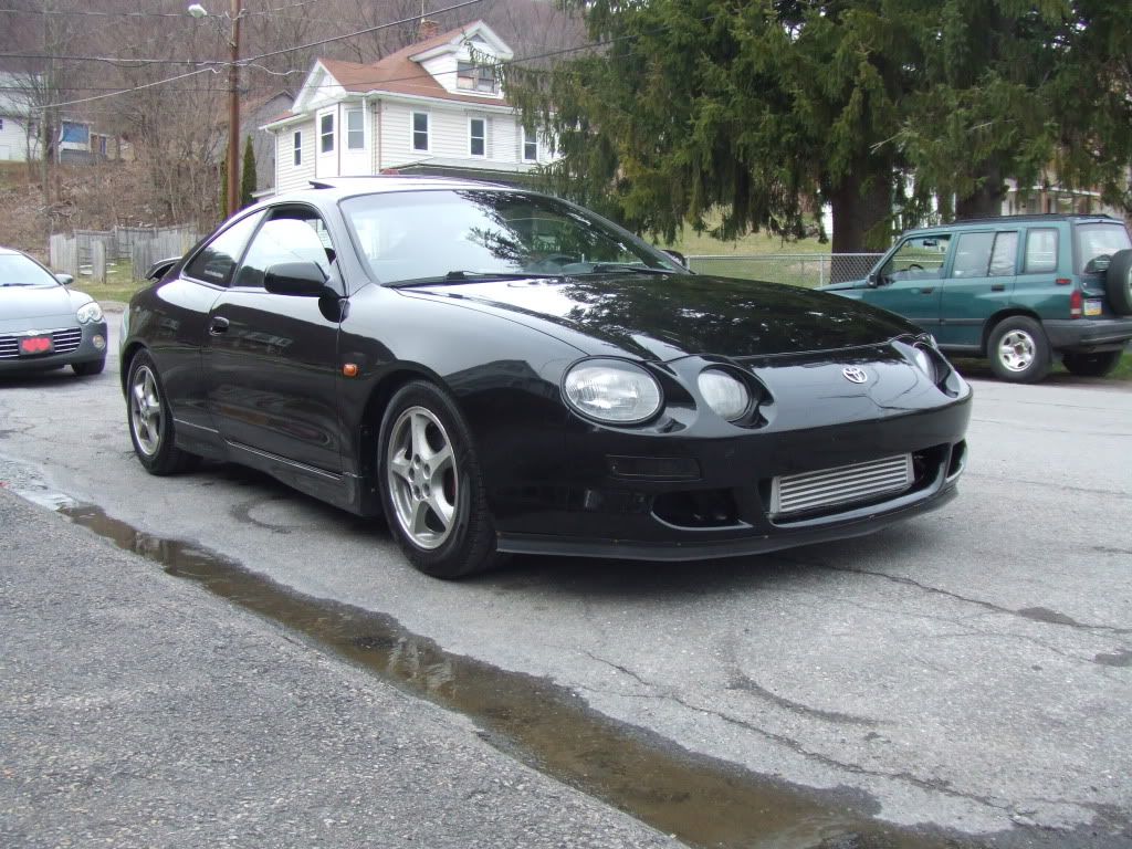

hey guys i have a major problem with my map sensor it will only read 5 psi and fall on its face ....... i no its not ment to read boost so what am i dealing with ?????? what map do i need to get ??????????? and im only runing a fmu so i need a map that will work with no tune .....HELP >>>>>> 96 celly gt 5sfe st204
