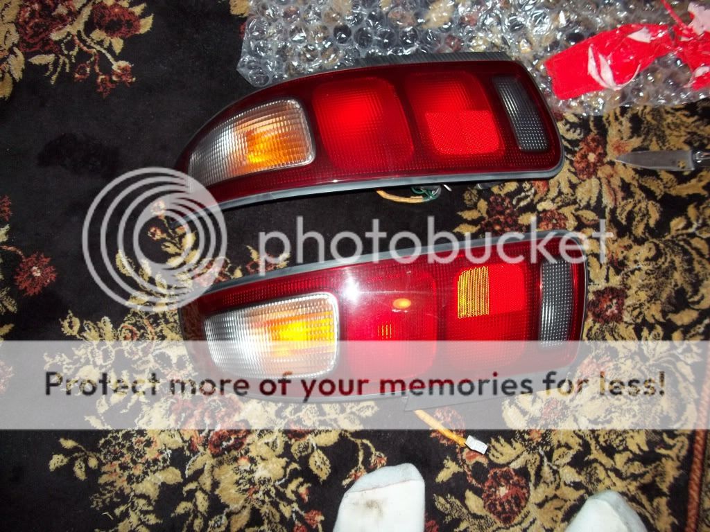

I realize that it may not be toooooooooo noteworthy to some, But I just got my 20B in the mail today biggrin.gif along with my new replacement Kouki tails laugh.gif . My injectors should be here by Monday or Tuesday and my UEGO and EGT setup by Wednesday. Hoping to have body work and all else finished by June 10th for CSP. Turbo looks nice except for some tape adhesive, nothing a little emery cloth won't fix though. No shaft play whatsoever and the turbine wheels look Pristine as far as any chips scrapes or irregularities go. See for Yourself
Had to throw the tails in for the hell of it.
