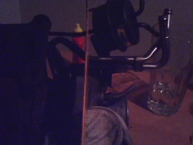

Aftermarket EGT, I have a bung in my down pipe for the UEGO. LONG story short it is in but the waste gate is not returning to the full closed position. The actuator rod is to long, the steel of the plate to move the position of the actuator is too thin and keeps flexing. So while I had it in I bent the bracket that the actuator sits on (or so I thought), during that time I got incredible boost (compared to the 26) at about 50% of the Turbos max output according to my boost controller. That output @ 50% was about 10-11 psi. Spool up was very smooth and quick, torque steer is off the map though (need an LSD, Be calling you soon Culp). Since then though the steel of the bracket and or it's holding plate has had a chance to relax again, sooooooooooooo... ...Tomorrow is another day. Tomorrow I will be either re-bending the rod to the specifications in how to, altering the bracket to allow for the rod length, or cutting and welding the rod to the proper length of I believe it is 7 3/8.

I see what you mean about the relocation plate,
I had a look at mine, yours actuator looks allright from that pic, maybe it needs to be brought up more or further towards the intake with some washers?

Yes, same principle different theory.
