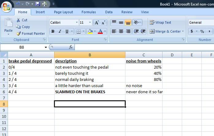

when i picked my car up from school after leaving it there for about 7-8 months i was driving it back home and there was a squeecking noise coming from the driver side wheels.
i thought its becuase of the rush the rotors might have happened. i was going to get my engine replaced so i didnt really care at that time.
now its annoying me.
when im driving it, i can hear it squeaking like a squirel or a mouse and when i touch the brake pedal, it gets louder and when i depress the pedal even more, it stops.
so heres a crappy excell looking thing for better description
bads are fine, about 70% left on them, rotors are fine too,
rear bearing was replaced about april last year but then my car kept breaking down so i would say about 3-5k miles on it
front is still old
how do u inspect wheel bearings?
