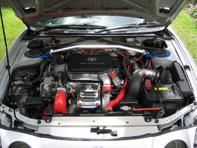

This is my engine bay and how things are hooked up

youve got a rusty as turbo and a possible fake SSQV, thats all i see. where are the hoses connected to it?

thats not a rusty turbo, thats whats the turbo connects too, u see the coupler that connects to the TMIC and the silver thing under the coupler? thats the turbo and that isnt a fake SSQV thats the "Black Limited Edition" SSQV, i have one on my setup, and that vaccum line is correct too.

Yeah the hot side has a small coat of rust on it mostly from sitting on its ass for 6 months...the mess with the long blue hose was me trying to figure out where stuff had to go...that goes to my Electronic boost controller and the AEM progressive water injection module...
The little thingamabob in the SSQV moves back with no difficulties...I cant understand why i keep hearing the Tututututu from the air intake and the BOV not moving... I will wash the BOV with some carb cleaner and buy a new hose to it and clean up some of the vac lines see what happens from there...
I ruined the outside of the SSQV with the ****ty ass snap ring from hell why the $#@@ cant they assemble it with the flange from factory how hard is that???
