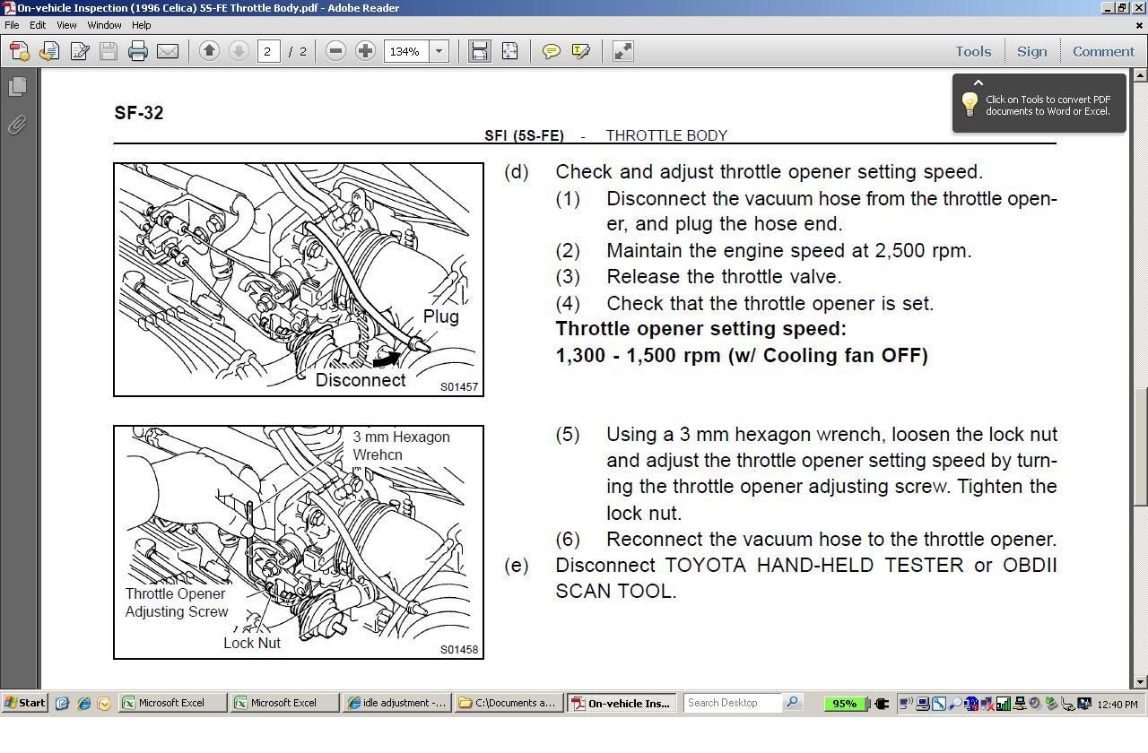

where is this? i have not seen this, pic?
94 Celica GT
04 Celica GT
89 Supra (Sold)
90 Supra (Sold)

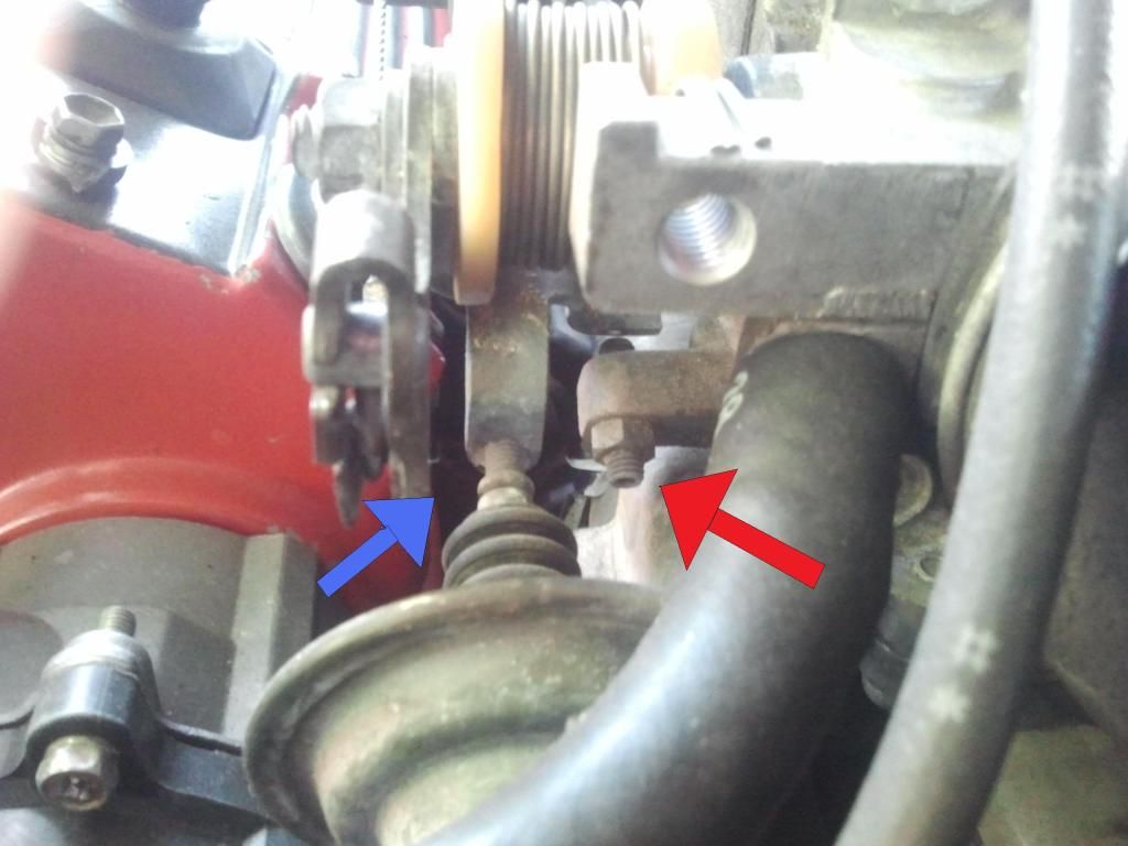

post May 2, 2012 - 6:25 PM
Special_Edy
Joined Oct 29, '11
From Haltom City, Texas
NOOO!!!
NO NO NO NO!
Dont touch the diaphram or the screw it pushes, its the threaded rod next to it
The red arrow points at the idle adjustment screw, the blue arrow points at the throttle opener adjustment screw(which you dont want to touch)
