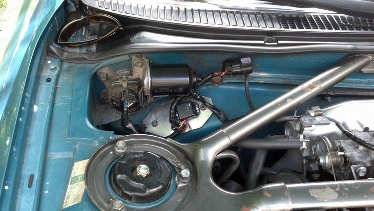

First of all you want to locate a nice cool spot in your engine bay to mount the map clamp so that it doesn't get exposed to too much heat. Here is a picture of mine after the install to show you what I did.
I plumbed my engine wiring harness through the middle of the fire wall instead of extending it completely. So i've installed my map clamp on the aluminum block off plate that I made to cover the factory wiring harness hole. This spot in the engine doesn't get too hot, so it should be a safe location for my map clamp.

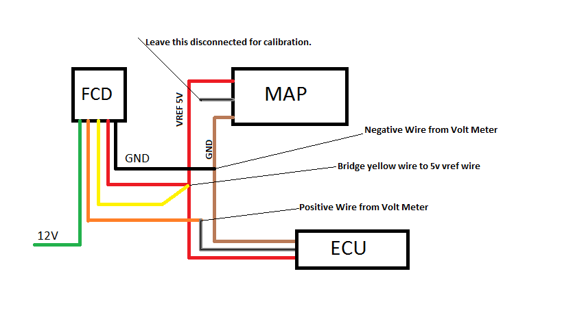

Below is a picture of how you should hook up your map clamp initially for calibration after you've found a suitable location for the map clamp in your engine bay. (note: I connected the green wire that goes to 12v to a 12v wire that comes out of the harness that connects to my windshield wiper motor. I used a multimeter to find which one of the wires on this harness received 12v when the key is in the ON and START position. The wire that you choose for your 12v source should be OFF when the key is not in the ignition.)
This is a method that I used, which was successful to calibrate the map clamp WITHOUT having to pressurize your intake manifold, or shoot compressed air into your map sensor hose.
Turn the key to the ON position, and you simply watch the volt meter as you turn the adjustment screw until it reads between 4.10v-4.17v (I set mine at 4.12). After you're comfortable with your settings get some clear nail polish and put it on the adjustment screw so that vibration during driving does not vibrate the adjustment screw to an undesirable volt output. (I chose to do this because I can use acetone to remove the nail polish if my setting were undesirable).

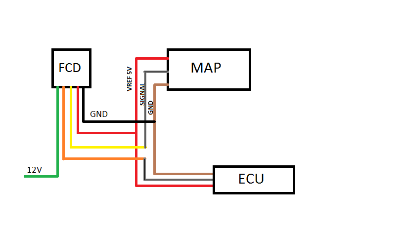

Let the nail polish dry for a few minutes....then you need to reconnect you wires as shown in the picture below.
Now take the time to solder all of your joints and cover them with heat shrink tape.
