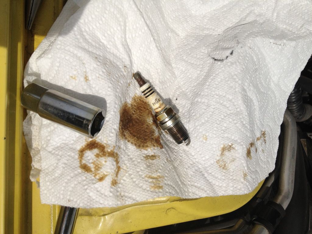

Okay well i just checked my spark plugs, and in the second cylinder there was a lot of oil in there, the spark plug was covered in oil,,,,I'm guessing this isn't normal???
![]() ![]() You can see the dirty dark oil on top. ![]() Anyone? |

Sounds like bad oil rings or valve seals on cylinder two.

Start with a valve cover gasket with tube seals and new plastic half moon seals at the ends of the head. Goto the dealer for these, their prices are not unreasonable and parts are best quality. Once that's done clean the whole engine down thoroughly and let it run and keep an eye on it. 5S engines leak from valve covers REALLY badly when they get older.

Ah yes, definitely try valve cover and spark plug tube seals first.

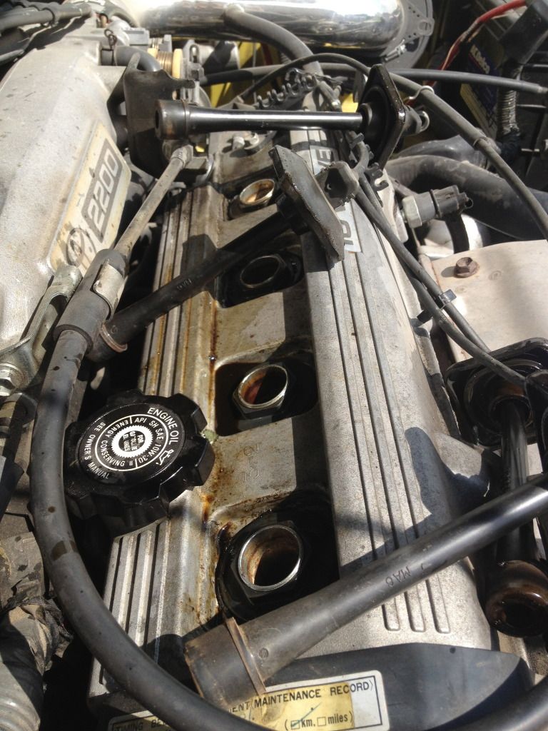

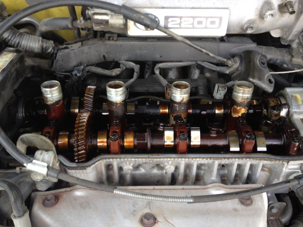

Alright well i did what you guys said and got new seals (valve cover gasket and tube seals),,,I took the valve cover off for the first time and its not as terrible as i thought it would look,,,I'm also wondering your guys's opinion for cleaning out all the sludge? what exactly is the method for that?
ANYWAYS BACK TO THE PROBLEM I ran the car for about 15 minutes only and there was no oil at all coming from the valve cover and i checked the second cylinder and spark plug and they were clean like when i put them in,,,so ill let you guys know if it stays this way... Thank you guys for all the help!! ![]() Old seals ![]() My odometer reads 260 000km how does this look? ![]() Anything i should be looking for? |

Well the spark plug seals that i changed definitely solved that problem,,,,Now i can get back to focusing on the original leak i posted about haha. Thanks for all the help guys

Little dirty, nothing horrible. Run some auto trans fluid in there for a few oil changes to clean some of the gunk out, about 1/2 quart in place of 1/2 quart of oil, so 3.5qt oil and .5qt auto trans fluid. Doesn't matter what kind you use.
for the valve cover itself, get one of those carb dip buckets and a plastic tub with lid big enough to hold the valve cover, dump the carb cleaner in the tub over the valve cover and let it sit over night, in the morning pull it out and go at it with the garden hose and some purple power with a scrub brush, toss it in the over at 250 to dry for 30 minutes OR just let it sit in the sun for a few hours. It'll be nice and clean again. Great time to sand and paint it if you wish. -------------------- |
