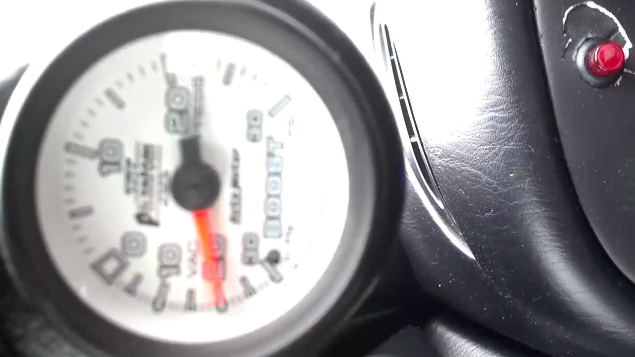

]Check out this video. My idle bumps just like the vacuum between 550-700rpms. It does this after the car has fully warmed up. Cold start the vacuum and idle hold firm until the engine gets up to operational temperature.
Things I\'ve done:
full boost leak test, and repaired the leaks I found.
smoke test, and repaired the leaks I found.
My question?....what else could cause this? Sticking IACV maybe????
oh yea...it\'s a 3rd gen 3sgte. Fully built...etc...most of you are probably familiar with my build. If not it\'s in the my project section.
http://s1190.beta.photobucket.com/user/bsa...403873.mp4.html

yeah thats very normal, it happens from time to time, usually blipping the throttle gets it back to stable.
for sure clean out your IACV with some carby cleaner, get all the grit out so it turns freely then give it some WD40 to lube it again
but yeah, this will still happen from time to time, nothing to worry about
btw that idle speed seems a little low, it should be around 900, so check your base ignition timing is set to 10deg in diagnostic mode
(when warm)

Check the map sensor. My idle went to crap after I accidentally cracked the hose nipple. A little jb weld and the problem was fixed. If I remember correctly you have an FCD wired into it. I'd check that too.
It would explain why this only appears when your car is warmed up (it enters closed loop). Plus your guage is showing 20inhg, which is the same vacuum I get. So a leak isn't very likely.
