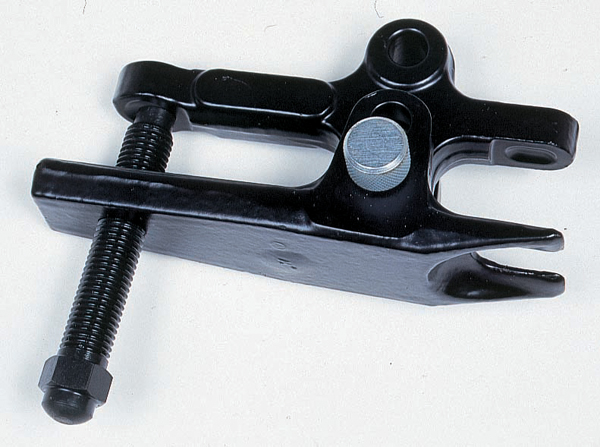

SwissFerdi Loosen the bolt if you can, then get a breaker bar... Nov 19, 2012 - 8:10 AM
rave2n Or..just don't remove it there.
Simply mark w... Nov 19, 2012 - 9:28 AM
czwalga All you need is a pipe that slides over the ratche... Nov 19, 2012 - 6:29 PM![]() ![]() |
