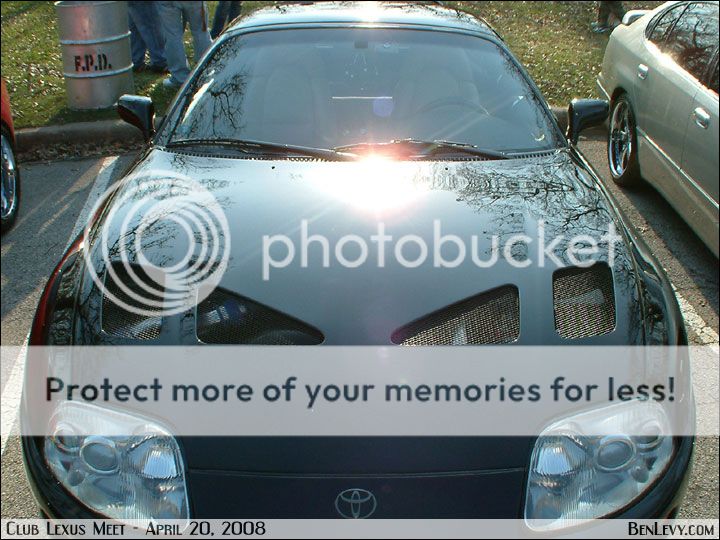

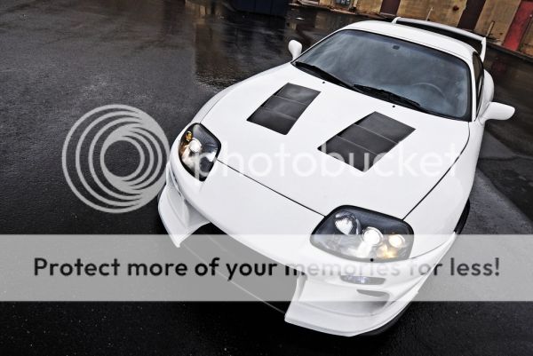

Im looking to make one of two supra hood for my orange celica. I will add the pics at the bottom of both. Keep in mind im pretty set on one of these hoods, there is no reason to bash on the style or have negative comments.
1) The first hood doesnt look like it has any sort of draining system, maybe because the vents are fairly far forward on the hood, and most of the water would fall in front of the engine itself. But I still feel like if i made this, I would want to add in some sort of duct system for re-routing the water.

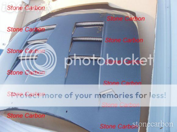

2) The second hood is much different and looks like it will need some sort of drainage system built underneath. Im curious if anyone here has done anything close to this?
3) Also I know the GT-4 hood has a vent, how do they address the water issue?

I think this picture the vents are much larger than the other pictures, I dont plan to make them quite that open

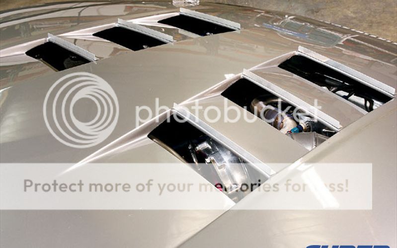

Hi,
the engine does not become in danger in front of some water, forget this point
the reason to use vents is to lower the engine bay pressure to get more air through the radiator package, picture 1-3 is not good designed, the airflow break-away edge in front of the vent
has to be higher then the highest vent point
design 4-5 is pretty nice
air is a hard to appraise medium, but i'am sure every designt except of 4-5 has no advantage or a negativ one
the next point is the cars angle of slope, thats affected the vent too
further you should use a area on top of the hood where the air pressure is low, not the front and windshield area
