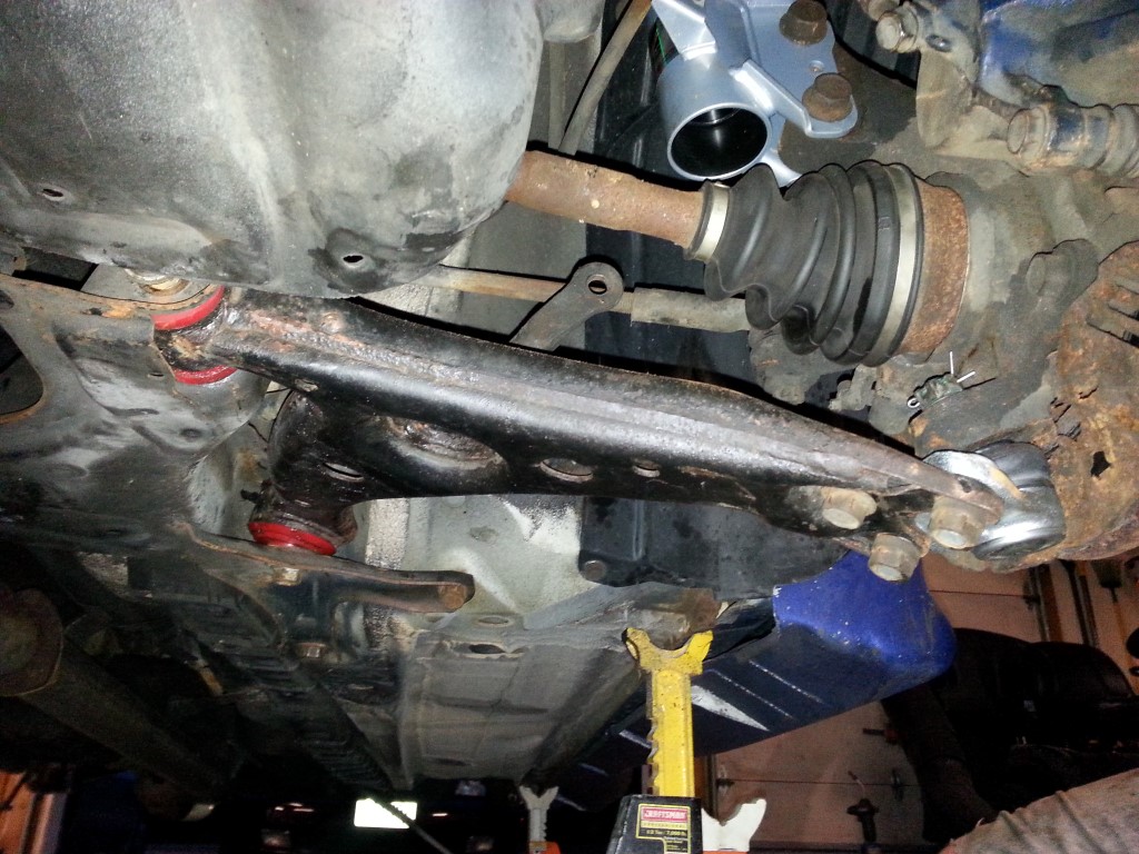

For the front, its just the 2 bushings in the a-arm, which are held in place with rings on the outside of the bushings, that hold them in place. as long as those rings are intact, you can just use a drill to drill out enough space to get a sawsall thru the bushing, cut the ring, and the whole bushing will just push right out.
then its just a matter of pressing the new bushings in, and reinstalling everything.

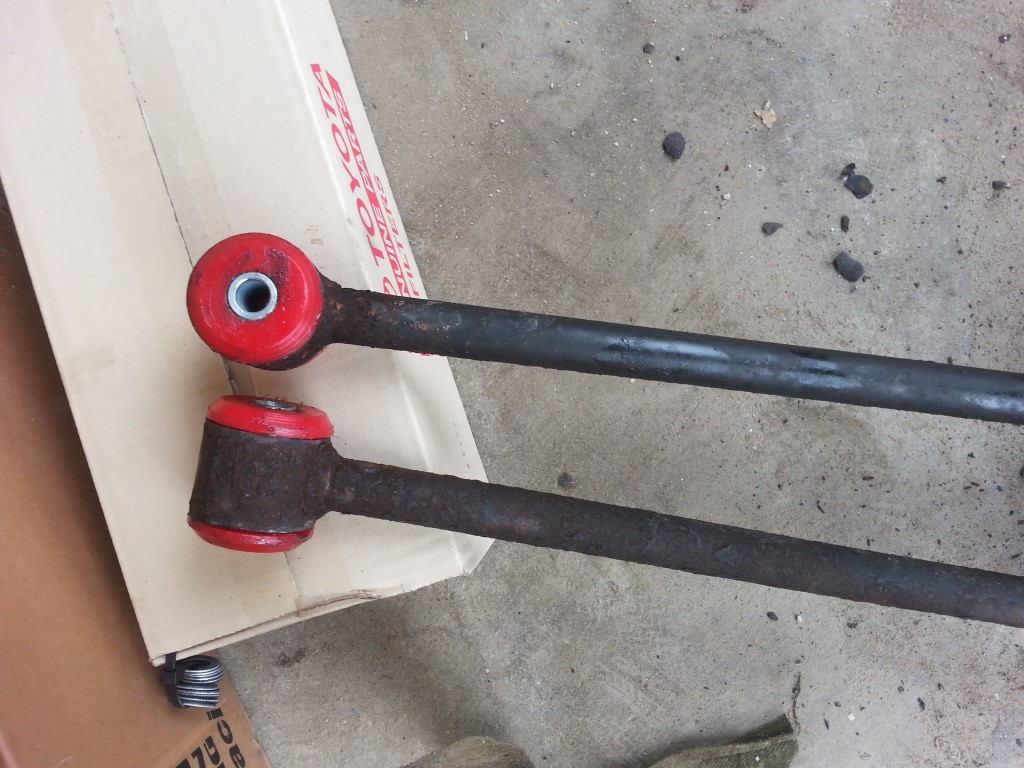

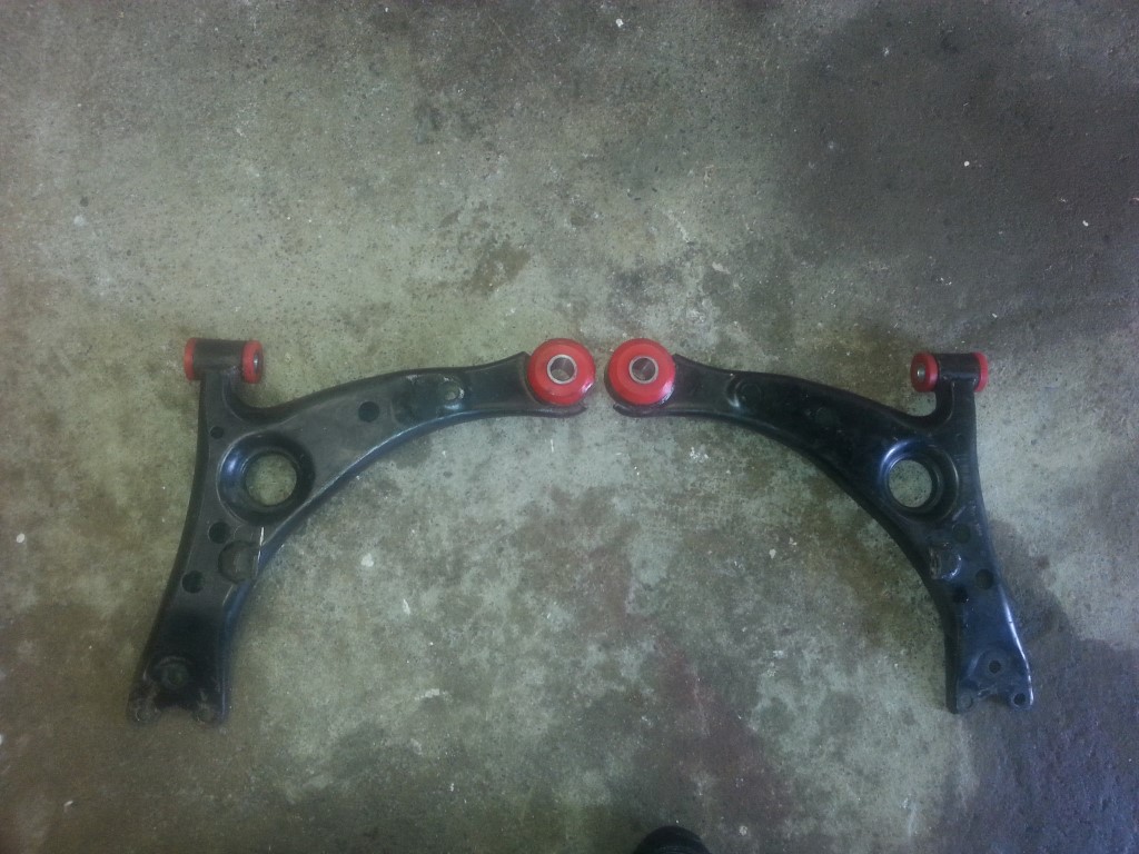

So, since Dustin has some spare front A-arms, we just installed the bushings into those, and here is what we had once we were done and ready to install em.

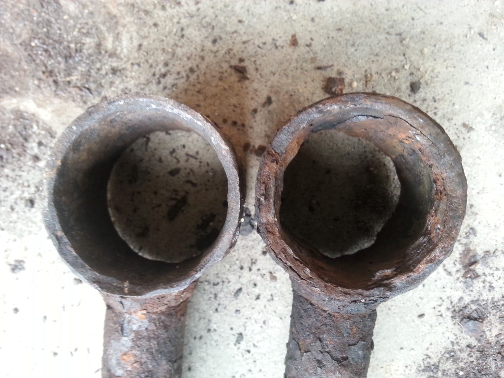

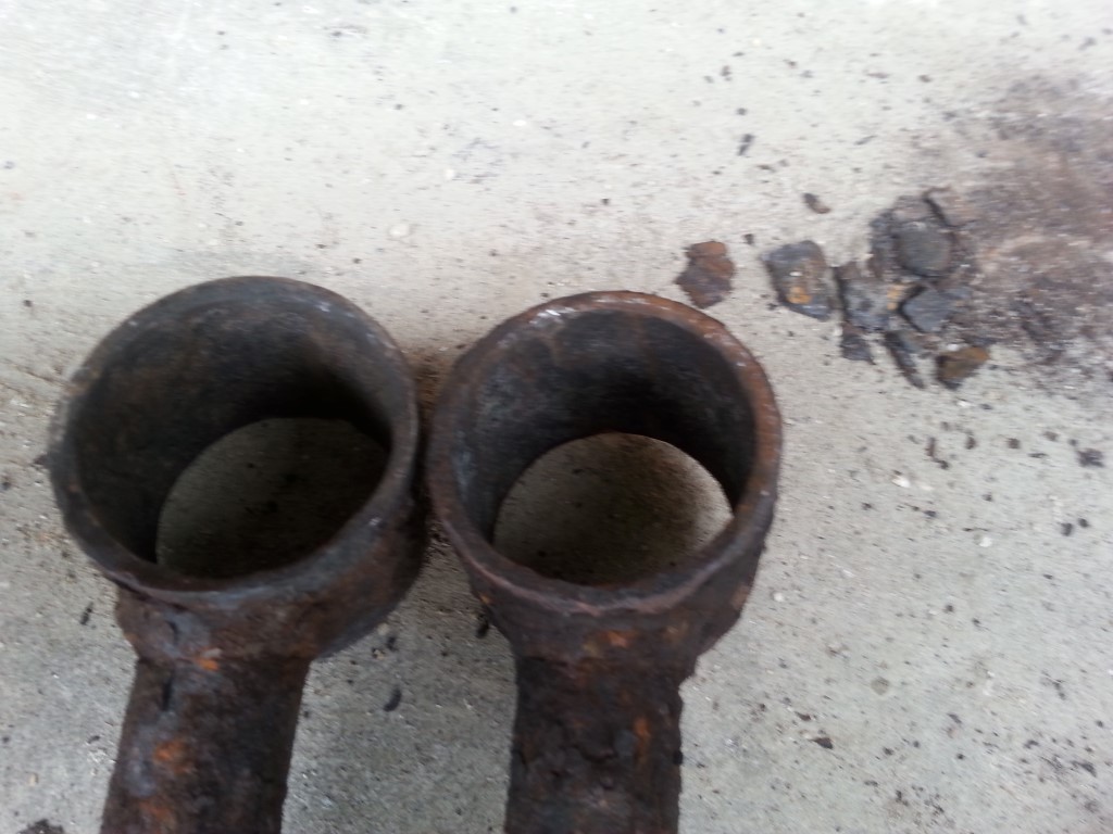

Then we went to do my rears, and noticed that the rings that hold the bushing in place, had actually rotted and basicly desintigrated as we removed the bushings.
I had to chip and hammer that crusty stuff out, basicly ended up smashing the ends of the arms a bunch with a 3lb sledge to break up the crust, then used a metal die grinding bit, to clean up the holes

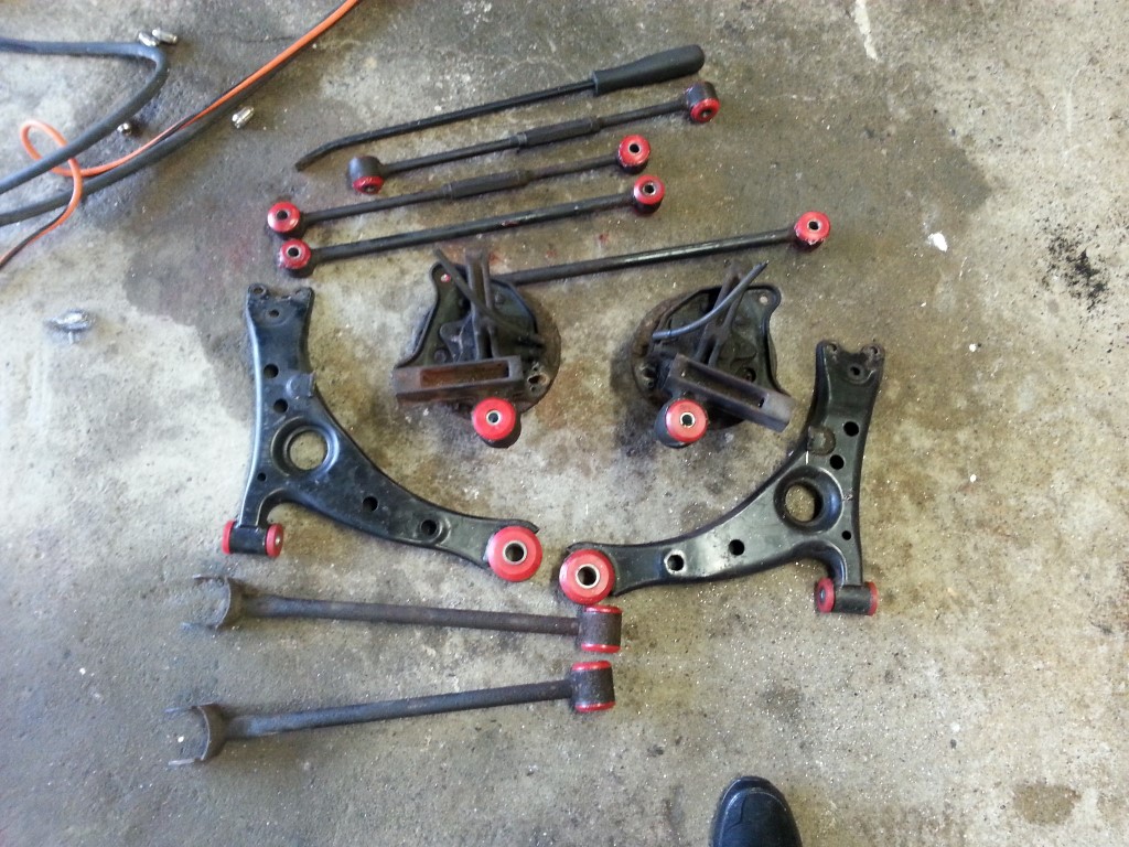

then installed the bushings in those:

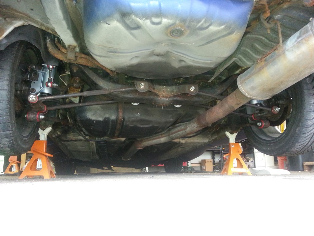

once we got those all done, and did the same to the rear hubs, we had everything ready to install:
We installed the fronts first:

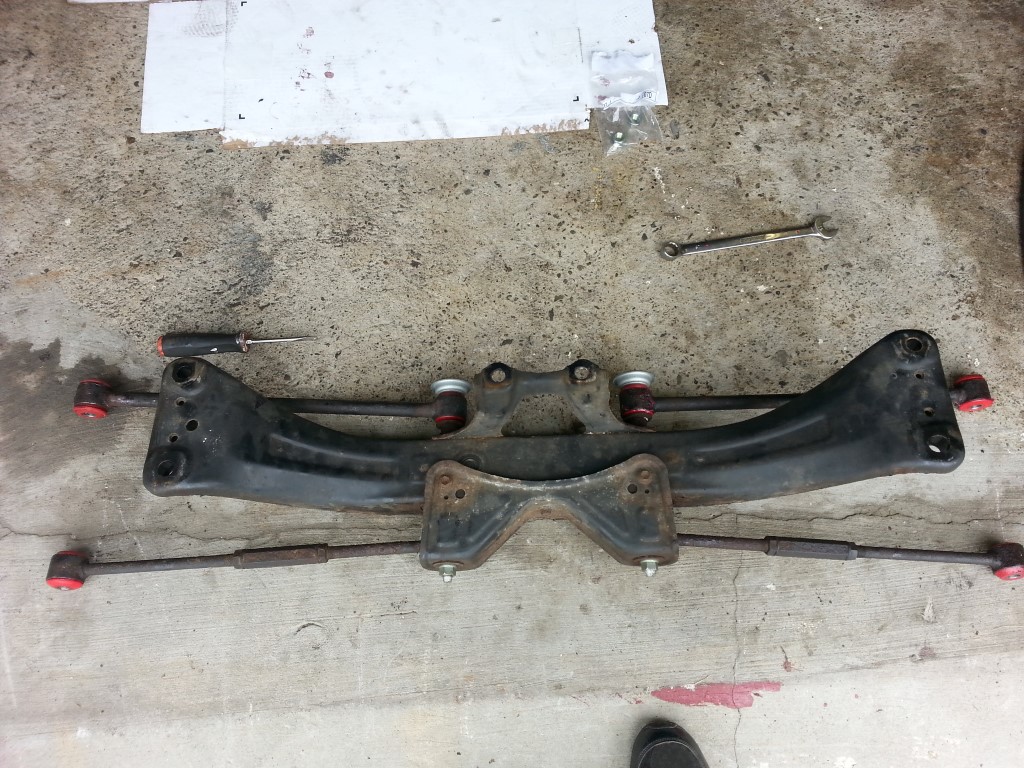

Then installed the all the arms on the rear subframe
And reinstalled everything in the rear

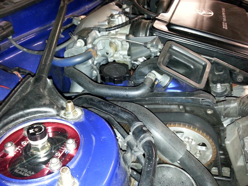

Once everything was all reinstalled, we spent a little time adjusting the height of the car with the coilovers, and got it close enough to let everything settle in for a few miles.
Now its just a matter of driving the car, and playing with the damper settings till we find our sweetspot
The initial impressions are amazing.
First off, the car really does handle like a whole new car, everything is nice and tight, very responsive, the bushing kit makes the car feel so smooth and predictable, its really great.
The coilovers are really nice, small adjustments of 2-3 clicks actually make a diffrence that you can feel, everything is just awesome about them in every way.
over the next couple days I'll play with it some and get a better feel for everything overall and make a nice detailed post about it.
