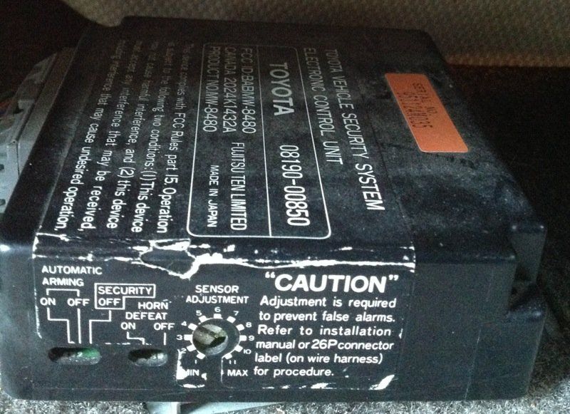

from what I understand it predates rs3000. It's apparently called TVSS. I think I'll post up a photo of the ECU

That looks like the box I had in my '96 Celica with keyless entry, but I may be mistaken. This is going to be a stupid question, but Luke, your car has keyless entry, right? It's definitely a different ECU from yours?

QUOTE (richee3 @ Apr 3, 2014 - 1:51 PM) *
yup, 100% different. I have the dealer option RS3000 system which is just a plain black box. Someone on here must have a keyfob for their '94. All I need is a picture of the back of the remote so I can see which FCC code is associated with TVSS, and thus search for compatible remotes

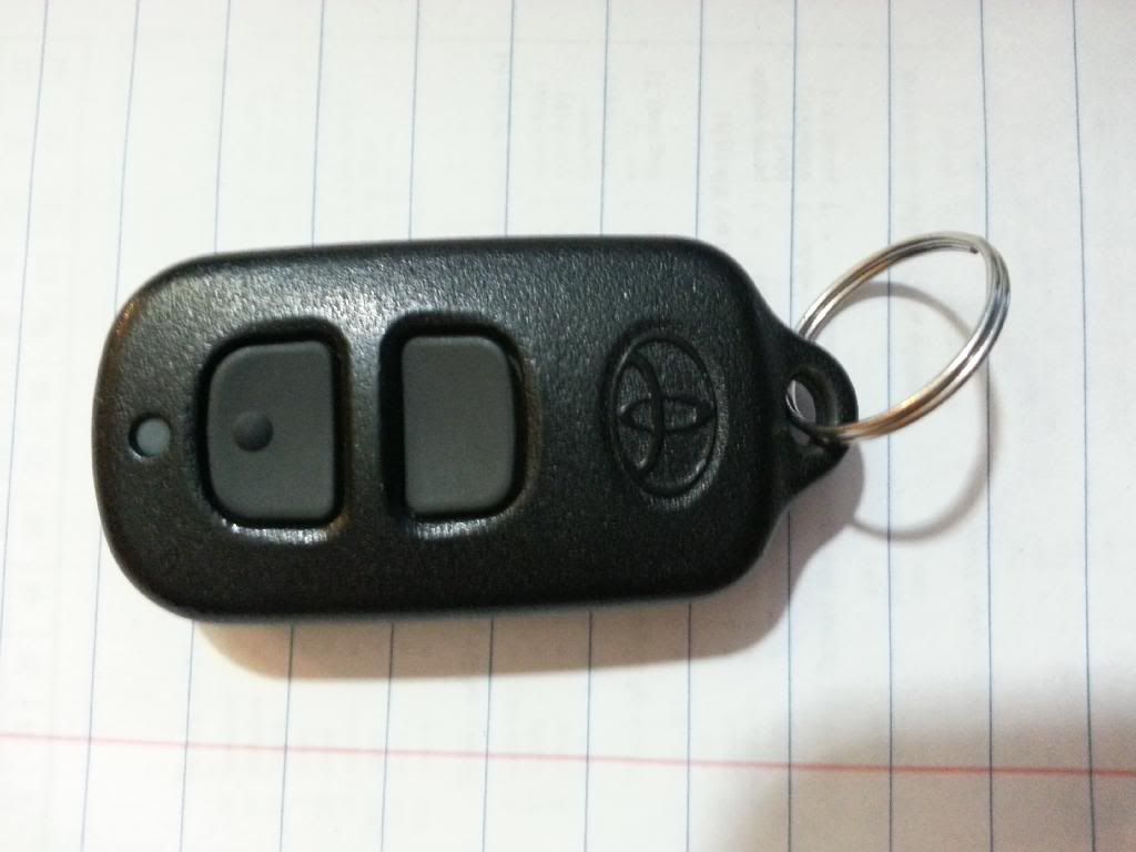

Just saw this and sorry for the late reply. I just read the back of my remote and it reads FCC ID: BAB237131-056. If you are second guessing it at all, talk to the local dealer and they can find the remote you need via VIN.
Btw, this remote is for my 95 GT.
Here are the photos.
Front
Back
If you want a photo of the unit itself let me know and i'll try to get one tomorrow.
