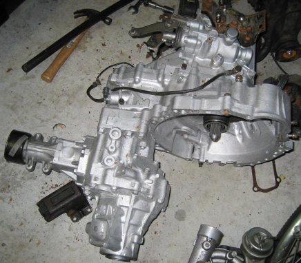

I have a complete 3sgte engine still attached to the subframe and transmission, which i have to strip down so i can ship the transmission. I have never done this before, so i just wonder if there is anything i should be aware of. Or if i can simply start pulling things apart. For instance, i dont know what to expect when i detach the motor from the gearbox. Any oil i have to remove? Some pictures or a quick how-to would be greatly appreciated.
I have this: ![]() And i want this:

So i should drain the gear oil before removing the axles then. And be careful not to wreck the spine when pulling the engine from the transmission. The starter bolts is a good tip! |
