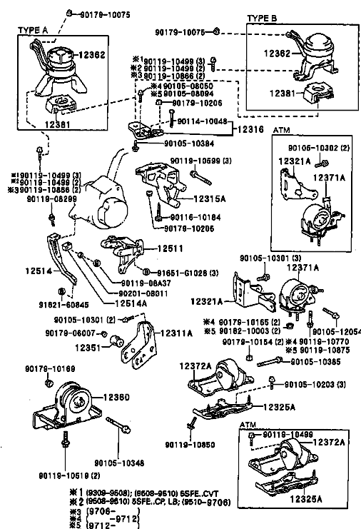

I'm in the market for some new motor mounts, and after searching on toyodiy, I can't exactly pinpoint which mounts I need. The car is a 95 Celica GTS, 5SFE, Manual trans, and I'm looking to replace the front mount, as well as the rear dreaded trans mount.
After Looking on toyodiy, I've come up with the following part numbers:
BRACKET, ENGINE MOUNTING, FRONT(FOR TRANSVERSE ENGINE): 12311-74180
BRACKET, ENGINE MOUNTING, REAR(FOR TRANSVERSE ENGINE): 12321-74320
Source: http://www.toyodiy.com/parts/p_U_1995_TOYO...LMGKK_1107.html
However, there's also a bunch of other things listed under Engine Mounting, like Insulator assemblies and Stabilizers. And after searching on Rock Auto, they have front and rear mounts for a standard transmission from multiple brand names, however none seem to match with the above listed mounts.
Can anyone point me in the right direction as to what I need?
Also, is there a brand that should be preferred over another? Or would it be best to go with an OEM mount from toyota?
Thanks in advance!

well what mount do you need? do you need the bracket that bolts to the transmission or the mount that bolts to the body of the car? I posted the part numbers for all the mounts in this thread
http://www.6gc.net/forums/index.php?showtopic=92362
Part numbers for the mounts are:
Front Trans Mount 12311-74180
Front Body Mount 12360-74050
Drivers Trans Mount 12325-74240
Drivers Body Mount 12372-74450
Rear Trans Mount 12321-74320
Rear body Mount 12371-74410
These are not cheap from the dealer, so i suggest you plan ahead and find them from a junkyard or on ebay

I'm not sure to be honest. I had my car at shop for other things, and had some speculation that mounts needed to be done and he confirmed that was the case. Im going to crawl under there now and take a look, as i didnt realize there was two parts to each, I thought it was just one mount that bolted to the body.
Would these part numbers include the rubber as well, or strictly just the metal mounting brackets?
My Celica!
post Aug 12, 2014 - 7:40 PM
jordisonjr
Joined Jan 20, '09
From Winnipeg
Took a look under the car, and the rubber has slight cracking on them, but all of the brackets are intact and not cracked, from what I could tell.
So from the image posted above, I'd gather the mounts I need are:
Front: 12360
Rear: 12371a
I managed to find these on Rock Auto, for about $60 for front and $20 rear. Also checked the link to Conicelli Toyota Parts and it came out to be 83 for the front and 60 for the rear. Would it be worth while to spend the extra couple of bucks to get the OEM toyota ones, or should I just get the rock auto aftermarket ones?

Those are just reference numbers for the actual part number.
12360 INSULATOR ASSY, ENGINE MOUNTING, FRONT
12360-74050 1 $118.53
12371A INSULATOR, ENGINE MOUNTING, REAR
12371-74410 1 $87.97
12372A INSULATOR, ENGINE MOUNTING, LH(FOR TRANSVERSE ENGINE)
12372-74450 1 $133.56
12362 INSULATOR, ENGINE MOUNTING, RH(FOR TRANSVERSE ENGINE)
12362-74430 TYPE A 1 $190.69
12362-74460 TYPE B 1 $164.91
Those numbers are all from ToyoDIY for my '98 ST204. I had a type A passenger side mount.

QUOTE (richee3 @ Aug 12, 2014 - 9:29 PM) *
Perfect, this is what I found too and its starting to make sense now. Thanks a lot.
So the full part number would be the bottom, next to the price? Did you end up doing with OEM parts, or Aftermarket?
