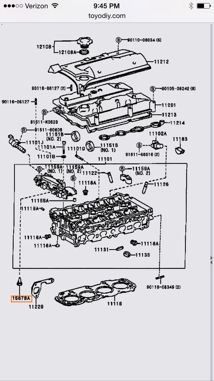

Is there an OCV Filter/ strainer for the redtop beams and if so, where is it? I am having problems with my beams and think I may need to clean it. Thanks in advance!

The filter is inside the head and unfortunately, quite a bit of disassembly is required. Have you tested the OCV itself?

I haven't tested it yet, but when the car warms up my idle starts to fluctuate as if I'm revving the car and then it drops. All I currently had was a 2jz vvti solenoid, so I switched it out and the car is fine now. Not sure if that vvti sensor even works with the beams though.
