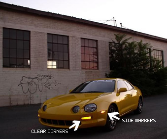

okay i see that commer has Clear Side Markers ,and Custom Clear Corners
whats the differnce betweent the 2 can some one show pics? and on my 95 celi st the side markers dont come on for sum reason when do the com on? and when do the clear coners come on? please explain wif pics thanks alot

The side markers come on whenever the parking lights or headlights are on. If yours don't, your bulbs are most likely burnt out. Both of mine were when I bought the car. The bulb type is 194.
The clear corners' dimmer filament comes on whenever the parking lights or headlights are on, at least from the factory. Once upon a time I modified mine so that my dimmer filament didn't turn on when I turned on the parking lights. Since then I modified it back. The brighter filament flashes on and off whenever the hazard lights are on, or whenever one of your turn signals is on.
Hope this helps. smile.gif Here's a pic of what's what.

could be explained better but is there away it could be a electrical problem if it doesent come on.... also coomer where did you get the clear corners and side markers from? thanks
post Feb 18, 2004 - 6:28 PM
You should check the bulbs and fuses. If they are both in working order, then let us know, and we'll help you troubleshoot it and find out what's wrong.
Also, I got the clear corners from CelicaKid84(He made them), and I got the side markers from ProCarParts.com. smile.gif
