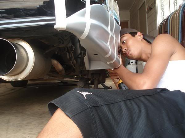

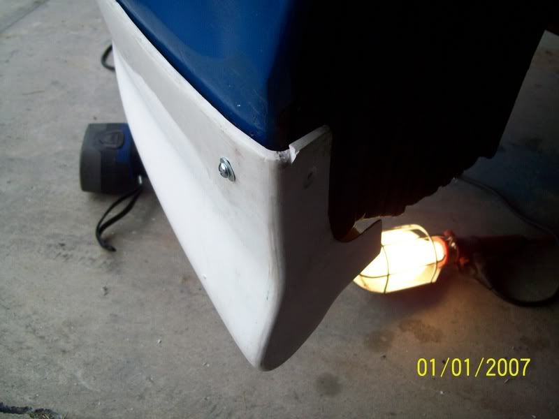

well here's how I did it:

see the screw hole in the first picture, inside the wheel well? screw it through there.... bondo that hole u put it the side. also 3m double sided adhesive tape = god.

QUOTE (devilsden97 @ Dec 28, 2008 - 3:59 AM) *
I saw that.. but where does it screw into? the only thing there is the plastic fender well

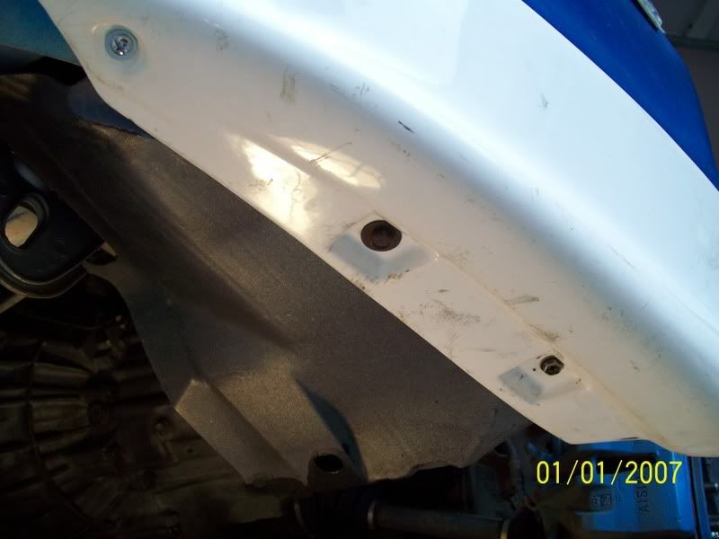

I think i'm ok.. here's a pic of rear(left) and front(right)...
mine looked like the right side

QUOTE (Jaws4God @ Dec 27, 2008 - 5:48 PM) *
BAD!!!!!!!!!!!!!!!!!!!!!!!!!!!!!!!!!!!!!!!!!!!!!!
just use the bottom holes, they should line up with the existing holes.

The bottom holes did line up, but without support for the top it didn't sit flush with the bumper...

double sided tape or expoxy. depends how fixed you want the extensions to be wink.gif

The extension arent gonna sit exactly flush. Like everybody said. Double sided tap. Also there is like a 1/4 fold on the inside of the fender well. Thats where the screw goes. Just a little one like a wood screw or something similar on the upper portion of the extension and one to two on the lower portion. And DOUBLE SIDED TAPE. Better patch that hole up in the side. oh yeah. for the fender wells u don't need washer on the screws

I only have the 2 main bolts to hold them and they sit flush, no tape, nothing more, but u have to use the largest washers u can fit!!!!!!!!
The middle screw is fine the one closer to the tire is too small, and the secret is..............don't be afraid to bend the bottom of your fender..i bent the tire side tab down towards the ground, and the bumper side up towards the engine bay...I've been fine like that for 5 months and they haven't flown off at high speed either..
(I used to use double sided tape before this and it just kept separating and stuff..)
I didn't do this but what they mean about the other screw I believe is use a long thin wood screw through the fender plastic as it will help guide the splitter closer to the body...maybe toyota originally used a plastic push rivet like the ones found in the interior??
