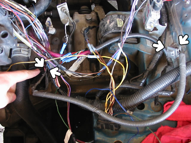

So I've got this extra plug from my modified harness sitting in my engine bay, and I'm curious as to what it's for. Here's the plug:
Now, my car is five-speed '94 USDM Celica ST. The car had A/C from the factory. Any ideas as to what this plug is for?

Can we see a shot of it in its natural postion lol? Like a shot of the plug in the bay.
Member of Team 5sfTe
post Mar 6, 2005 - 4:53 PM
Here's a couple pics I just took.
Attached Image Attached Image

I will go look in my bay and take some pics. BAck in 10 min
post Mar 6, 2005 - 11:52 PM
OK I took some pics. I didn't resize them so you can see them better.
the bad news is I didn't find the exact plug frown.gif but I did find one very very similar. It was the only one with ONE wire to it in that area. ( blue wire )
first the area
pics of plug
pic of it plugged in (dead center )
it is probably a coolant temp sensor. It is plugged in right next to the lower radiator hose ( thermostat housing I think )
it was the only one that was on that side of the bay with one wire that I could find. I would assume the 94-95 are the exact same but maybe not. Maybe I am looking in the wrong area ?
hope that helps. I will check again tomorrow morn when it is light out.
post Mar 6, 2005 - 11:58 PM
looking at batmans pics, its either the coolant temp snesor (normally green color, tho), you cosld start injector time switch, or your water temp sensor.
so if the temp gauge in the car works, and you have no problems starting the car on a cold day, then it must be the coolan temp.
post Mar 7, 2005 - 1:58 AM
My temp gauge works perfect, my car starts perfectly on cold days, and all of the plugs are plugged into the spots near the thermostat/coolant hoses. I do have the plug you took pictures of Batman, and it's plugged in where yours is.
So the mystery continues...

o2 sensor .....
I will return one day.
post Mar 7, 2005 - 2:11 AM
QUOTE(defgeph @ Mar 6, 2005 - 11:03 PM)
o2 sensor .....
[right][snapback]254099[/snapback][/right]
You know what? I bet you're right. I know we had to wire in a new four-wire sensor for the swap. Can someone confirm that this is the o2 sensor plug?
post Mar 7, 2005 - 8:26 AM
it could very well be the o2 since its a single wire, but on the 5sfe and 3sgte the plug sits on the right side of the engine bay not the left. that could have changed on the st tho.
start the car up and check that plug with a mutimeter to see if its still wired up to anything on the ecu .
This post has been edited by lagos: Mar 7, 2005 - 8:28 AM
post Mar 7, 2005 - 12:50 PM
plug for the o2 sensor
post Mar 7, 2005 - 1:08 PM
