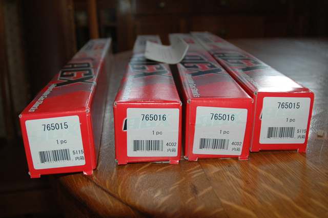

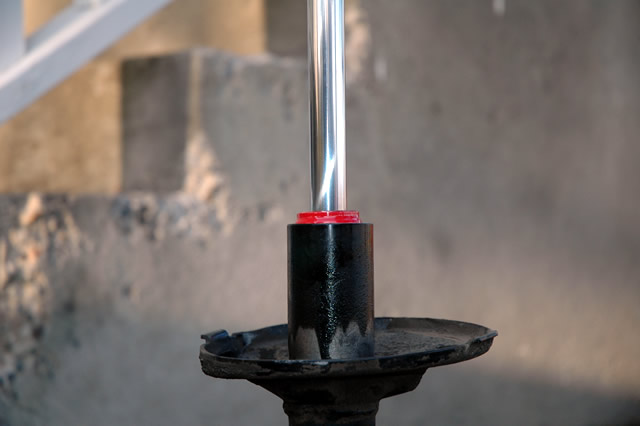

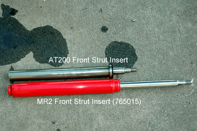

I'm so confused...I got my MR2 inserts today and they don't fit at all. The MR2 fronts alone stick out higher than factory Celica front insert, so they won't work. And the MR2 rears are even longer than the MR2 fronts. frown.gif
But Punch claimed he shortened the strut assembly by 2" and still had to run spacers...I don't see how that's possible.
I double-checked part numbers and I indeed got MR2 inserts, so I have no clue what's going on. frown.gif
Can anyone help me?
Edit: Pictures Added.
The four MR2 insert part numbers...which match up with those online at http://www.kyb.com

AT200 insert and MR2 front AGX insert side-by-side
MR2 AGX front insert in AT200 front strut assembly...notice how it sticks out

Well... there goes that short stroke theory. heheh... What I would do... is extend the casing. If you can weld... or know someone who can... it shouldn't be too hard. The problem now is the stroke length... which might be a bit tall... but I think it may be small enough that it shouldn't matter. Hmmm... sucks... cause I thought it *should* have worked. It can still work, cause it seems the shock does fit alright into the casing...

Couldn't I just cut off the metal thing on the bottom of the AGX strut to get it to fit just about perfectly in there? And wouldn't you worry about MR2 front AGX inserts blowing in the front of a Celica?

You could cut that piece off, depending on what it is... heh. If it's just a welded on space or something, then yeah... you can probably remove it and be ok. As for running the MR2 fronts... there's always possibility for blow-outs because the shock isn't designed for that sort of weight... but it'll more than likely be a gradual thing. Best advice I could give, try it and find out. I would venture they won't last as long as a shock designed for heavier load... but it should be OK... good luck... keep me posted.
