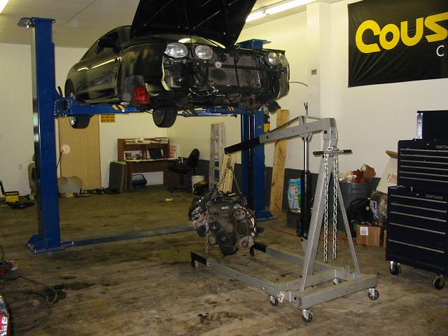

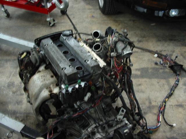

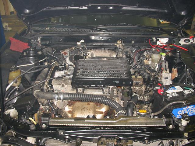

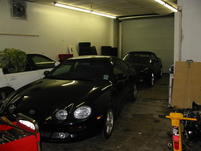

Engine resealed with new timing belt, ready to go. In the background, the victim waits...
AHHHH! It's the black Celica of DEATH!!!

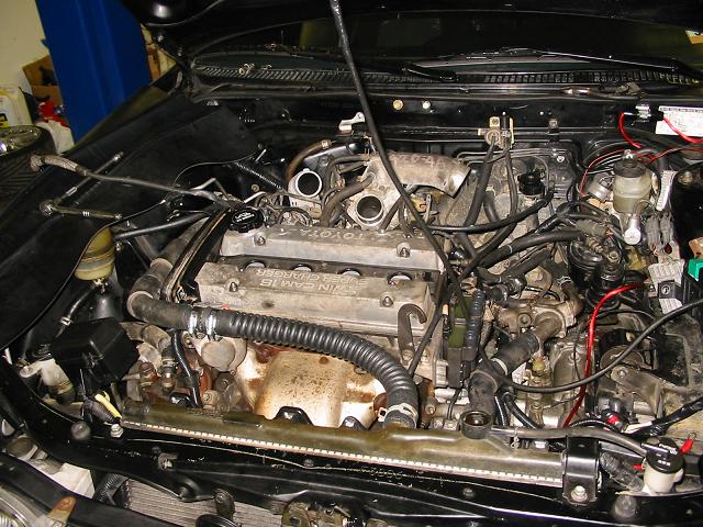

Remember kids, when swapping to a 4AGZE engine, you'll need the backing plate off the 7AFE engine. A new rear main seal is a must too!
New SPEC clutch installed and the tranny swapped over from the Celica. Yes, I know it's ugly, but around here we make things that go fast, not things that are pretty tongue.gif
This post has been edited by Dr_Tweak: Jul 26, 2006 - 8:58 AM

lol the motor is looking kinda rusty... lol i wouldnt wana pop the hood with that in my car!
lol but the good thing is that people can look at ur engine and be like whatever, than u can show them what an old engine can do lol
Is this good enuff 4 ya? :D

sure are some haters floating around 6gc lately..
btw you wont be able to see most of that with the engine in the bay.. also a painted exhaust heat shield and valve cover would do wonders for that engine.

Is that a MR2 GZE? I didn't know the MR2 came with DLI. I think that is an AE92 GZE.

Answers to questions: My understanding has been that the only car the MAP/DLI version of the 4AGZE came in was the AE101, and this is the MAP/DLI version. I'm pretty sure that the AE92 had only the AFM version.
As for the transmission, the C52 tranny has been used in almost every Corolla swap that I can think of, and it's a very rugged transmission. I've never once heard of a 4AGZE breaking one. Considering the simplicity of swapping it over instead of making the E58 work, it's a very logical choice.
Also I've cleaned the engine up quite a bit and it looks a lot better now.
