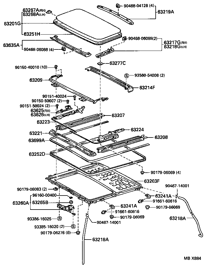

Ok...So I am driving down the road and the little Bar that slides under the sunroof flies of while I have it opened!!!! For a better description....It is the little object that seems to be used to deflect air up and over the opening in the roof.....But needless to say I don't have one anymore. My sunroof closed but now won't open all the way.
I need a part number for this object if anyones got it. If I have to I will draw a picture in Paint or whatever and post it up here.

63209 is that piece that flaps up when you open the sunroof. That thing gets so much abuse!

So it's roof wind deflector:
for made 09/93-06/95 = 63209-20090
for made 06/95-up = 63209-20091
