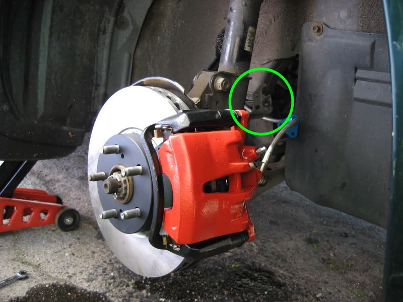

On the Brake rotors themselves, there should be 2 random small holes in between the holes for the Studs. They are tapped so it looks like something should be screwed into them. Well, this is exactly what they were designed for. You will need to get 2 long bolts (about 2 to 3 inches maybe longer) that are the same thread as the hole on the rotors and screw them in, the will hit the spindle and therefore creating leverage against the rotor, and therefore the more you turn them it will slowly take them off. You should turn them evenly to take the rotor off evenly. http://cgi.ebay.com/ebaymotors/94-99-TOYOT...sspagenameZWDVW
here in this picture you see the holes im talking about, This is an aftermarket rotor, and im not sure if your's is stock, but Im pretty sure stock rotors have them too. Let me know how that works out for you.

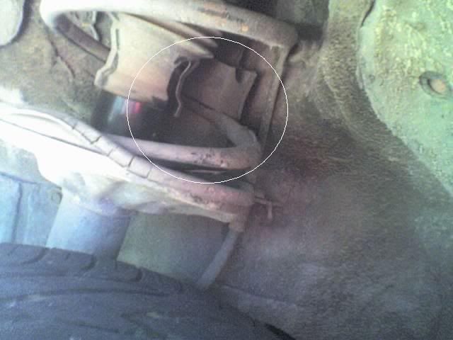

While i was down there today I also saw this IPB Image
I was reading something bout rubber stoppers they put on mr2's in shipping from japan, and then that caught my eye.

IIRC the bolt holding the brake line to this bracket fits in those holes
