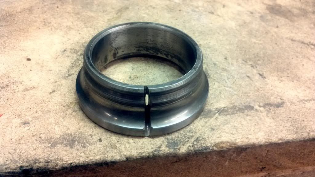

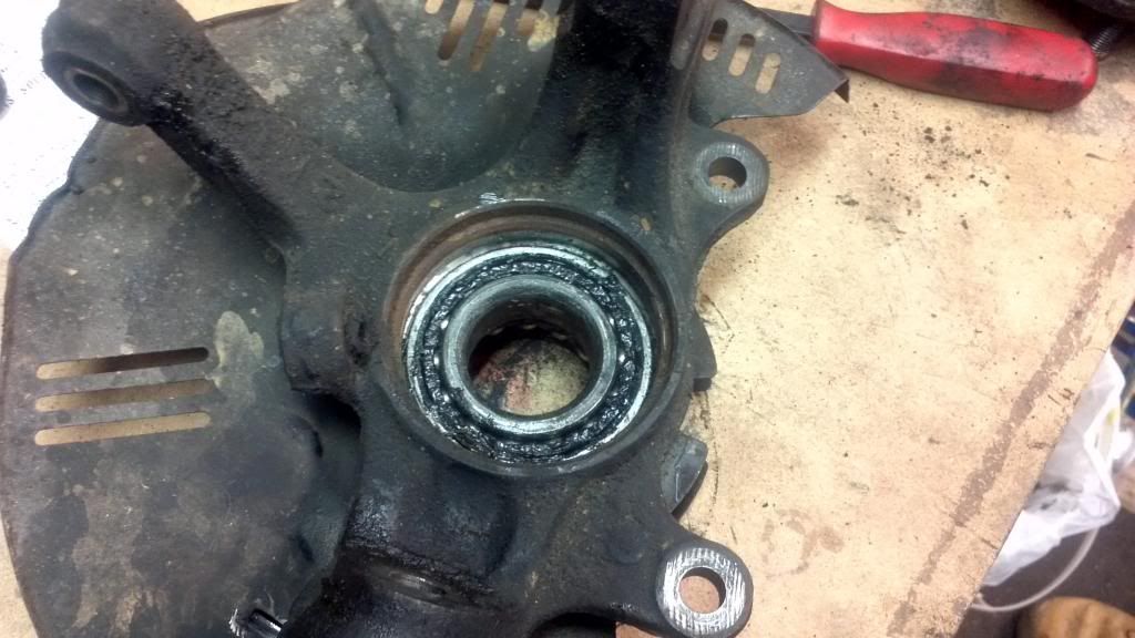

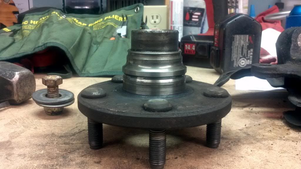

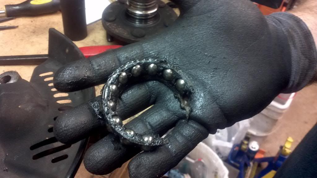

So I got to take the front end apart and fix it last night
Special thanks to my friend who has a garage and a lot of nifty tools including his own press
Unfortunately I wasn't able to the whole job including the struts : /
but I can wait for another month or so
In the mean time I had the CV axle, outer tie-rod, and ball-joint, once we got it apart we saw for sure it was indeed a wasted wheel bearing
and the ball joint was pretty weak too
I'd say this one is toast
damnit the inner race separated from the rest of the bearing and stayed on the spindle, now how are we gonna get that off?
then he whips out his dremel tool with a little bitty cutting wheel and zips right through it
technically the surface of the spindle and the knuckle were worn just a bit, we measured 0.064 off in a few spots
maybe a professional would insist on replacing them but I didn't think it was bad enough, and wasn't about to scrounge the U-pick-it lot when it just snowed and -30* wind chils
so we just put it back together and its just fine
we pressed the bearing out/in ourselves instead of taking it to a shop( it was Sunday), my friend wanted an excuse to use his press,
but really he ended up using his ball joint press kit instead,
very similar to this one but bigger with a whole bunch of different sizes
http://www.harborfreight.com/ball-joint-se...icles-4065.html
now that I have it back together it sounds and feels much better, still a bit squirrely 'till I get it aligned
but now I can here another little noise and I think it's the rear wheel bearing on that side, I smacked it into the curb at the same time I'm gonna assume I need to change it too.
Bust a Deal; Face the Wheel.

In your Jan 5 description of the work you and your friend did to the front wheel of your Celica, the first picture shows the steering knuckle. Would you do me a favor and ask your friend how I might bend those two 'ears' that are part of the knuckle. I've been renovating all the brake parts of my 94 Celica and ran into a problem where the caliper mounting bracket is bolted to the right side knuckle, namely those two ears. They are slightly bent outward and I want to take a sledge hammer and bang them back into alignment.
But I thought, isn't the knuckle a cast iron part? And isn't cast iron a rather fragile type of metal? If I took a sledge to those ears might I not break them off?
I am looking for a way to "adjust" these ears just a bit (about 2 and 3 32nds of an inch further away from the rotor) so the caliper mounting bracket will stop scratching the metal of the rotor. The left side ears are both 21/32 of an inch from the rotor, whereas the lower right side is 18/32 of an inch, and that difference is huge when it comes to aligning the mounting bracket over the rotor. TX
post May 27, 2014 - 1:34 PM
VavAlephVav
Joined Dec 3, '13
From Missourah
Off the top of my head I might suggest heating the metal and then bending it just a bit. but that's not a professional response, I'm not sure my friend will have much of a better solution than that.
