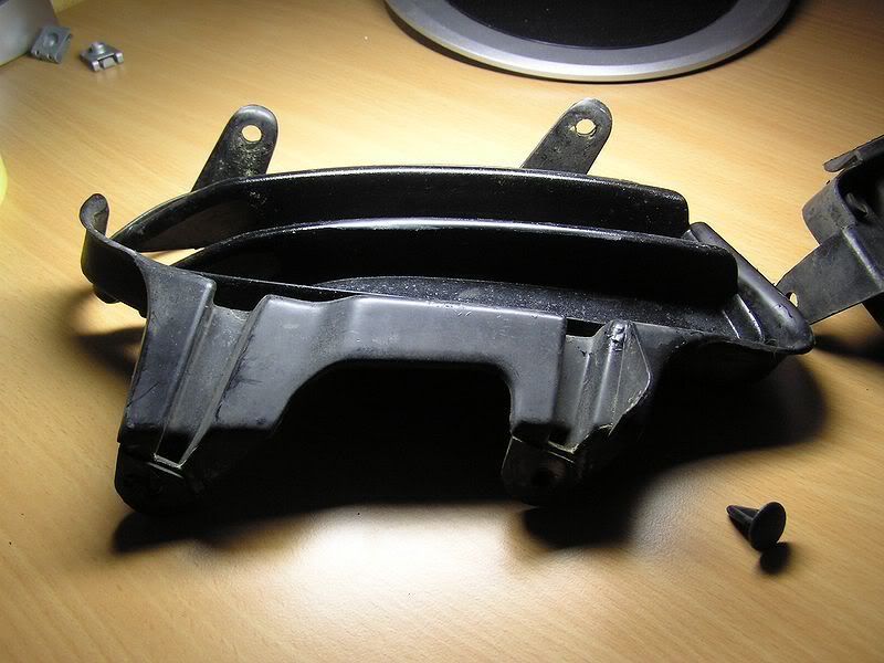

Hi, as the topic description states, does anyone know how to remove the black fog light cover on the facelift model?

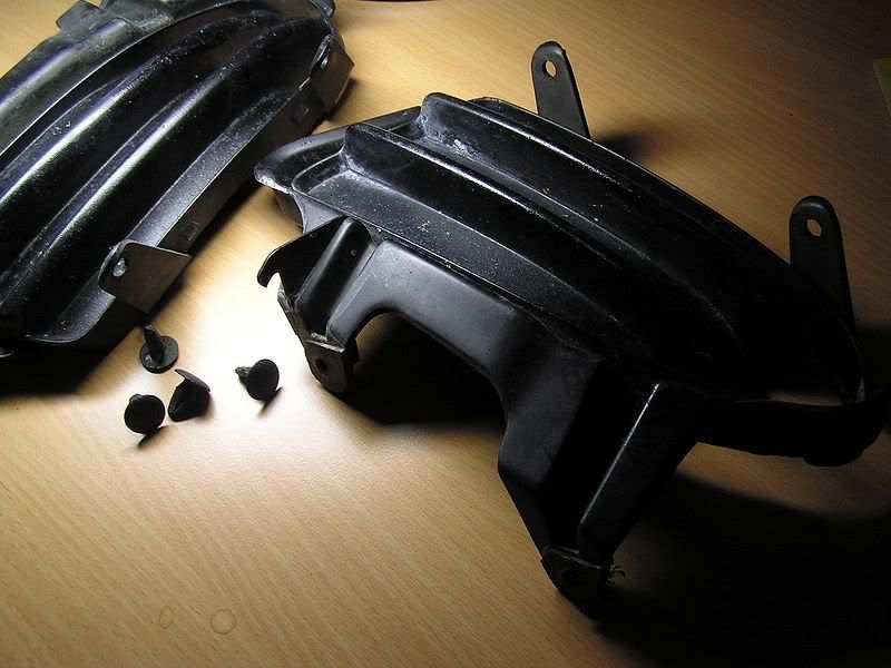

True is now it is few years ago I did that but from what I remember you need to remove two screws in the bottom (those screws holding also cover-panel under the car) and two clips on the top (you can see them in the picture below). No need to remove the bumper at all.
