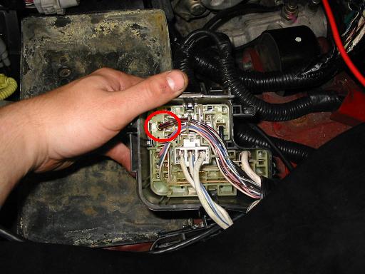

ok
1. the check engine light is not on. and does not come on at all when keys are in
2. cheked fuse connections and interior connections they appear fine
3. there IS power at the bk-yellow wire ad the bottom of the fuse box (there were two a big and a small but getting 12 volt on both)
4. there IS power to the bk-orange wire at BOTH the coil and ignitor
the only things i know that aren't set yet, are the vac hoses to the EGR that came from the 5sfe, and the large ground behind the intake manifold

ok
Is this the wire you checked in number 3? (It may be black/yellow or black/red):
That's the one you need to check for 12v with the key to on. Also, with the key off, check for resistance (continuity) between this wire, +B in the diagnostic terminal, and +B at the ECU, which is at the end of the 22-pin connector, and is either black/red or black/yellow (it should match the color of the wire in the fusebox).
Then we'll go from there. Shoot me an email when you get back on Sunday and if I can I'll give you a call.
