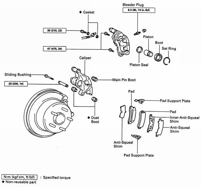

- - zipstrips   does anyone have a image of the parts needed to co...   Jul 17, 2006 - 7:26 AM

- - zipstrips   any actual pictures of the ST and GT parts, not a ...   Jul 18, 2006 - 3:40 PM
