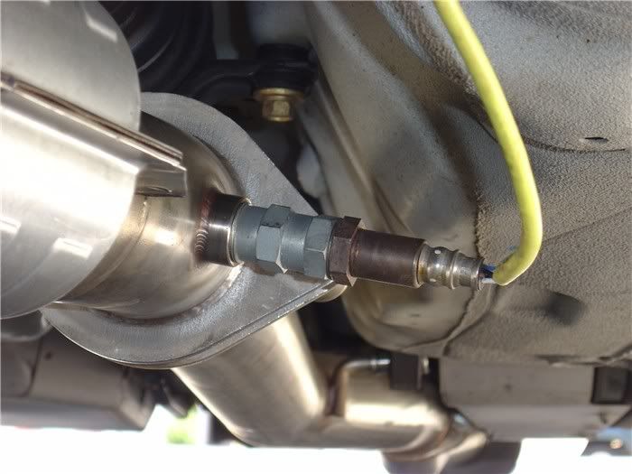

removing one of your two cats reduces the exhaust gas filtering which is why the CEL is coming on. getting a high flow cat is a step in the wrong direction.
to trick the O2 sensor you could try something to pull the O2 sensor further from the exhaust gases. I am planning on doing this trick with my exhaust after I turbo since I will be removing the cat and going straight pipe. I am not sure if it will work but it's worth a try.
this example is from the Subaru guys [I think]. They used spark plug non-foulers from the Help! section at Autozone. I can't find the original post from it but I did save the picture...
