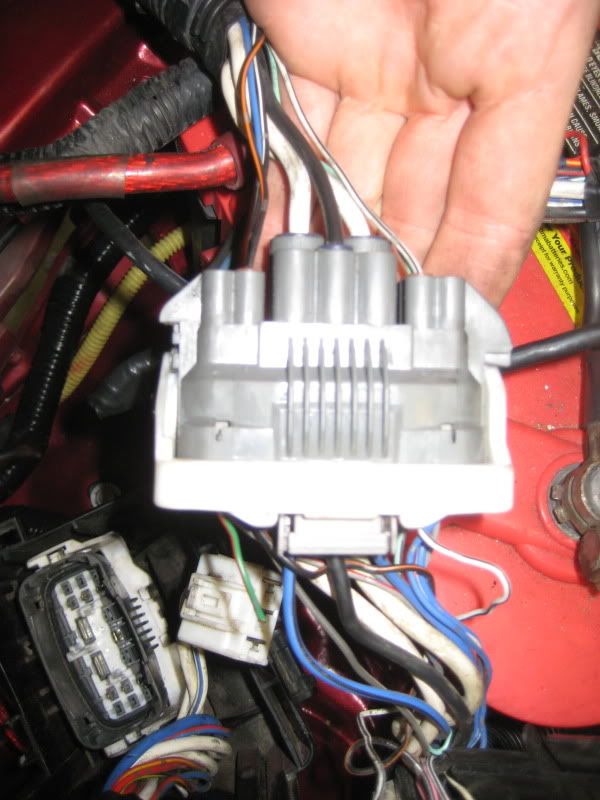

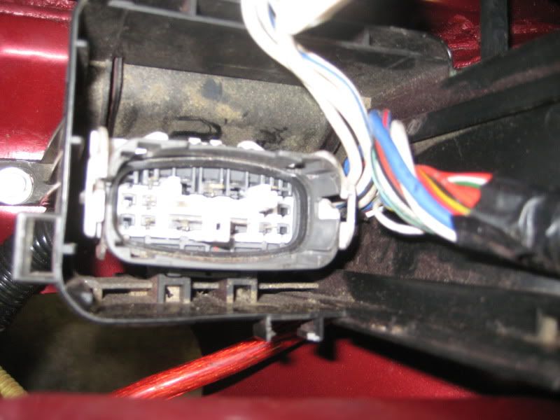

Joe looks like you are missing the EA1 plug... the fuse box itself stays in the car from your stock motor and the EA1 plug from your harness just connects to it. My motor was in a ST and a GT car and the fuse box is the same. Also, I believe those two heavy gauge wires that are also cut, but in their own loom there are to the positive terminal on the battery and the other loom part goes to the EA1 plug for the under hood fuse box. this is the one I'm talking about, that goes into the bottom of the fuse box.. if so, I have one I can send your way that you could wire into the harness ![]() ![]() you can see that part of the harness going into the fuse box and the other heavy wires on top would go to the battery, this is where I just sent the power wire to the trunk when I moved my battery on my swap
