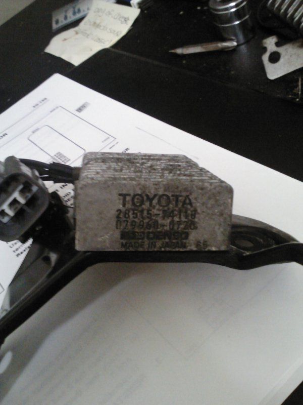

How important is this fuel pump relay control resistor, and where exactly does it plug into the wiring harness. I will be ording is next weekend if need be
and also do I need to order the fuel injector resistor pack like in the mr2? ![]() This post has been edited by Lil-Joe101: Jul 22, 2012 - 3:23 PM -------------------- From Japan to Texas my st202 follows me.

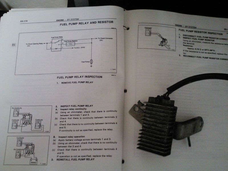

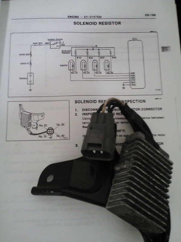

But from what I understand, you can use the 2nd gen injector resistor pack Had me worried I was missing a part so I went got my book out, and removed both resistors from my harness. First pick is the "injector resistor pack" ![]() Part number if you need it. ![]() Here is the fuel pump relay resistor So yes you will need that item you have in your first post.

rave2n other part number is 23080-74030 Jul 22, 2012 - 4:57 PM
Lil-Joe101 QUOTE (rave2n @ Jul 22, 2012 - 4:57 ... Jul 22, 2012 - 5:00 PM
rave2n 28515-74110 or last digit 8...mine is dirty.
i th... Jul 22, 2012 - 5:02 PM
Lil-Joe101 Edited again thanks. Jul 22, 2012 - 5:04 PM
Lil-Joe101 Searching the part numbers with google and nothing... Jul 22, 2012 - 5:12 PM
Lil-Joe101 Now Im really confused. What is the difference and... Jul 22, 2012 - 5:17 PM
rave2n Hmm the first one is the st205 injector resistor p... Jul 22, 2012 - 5:23 PM![]() ![]() |
