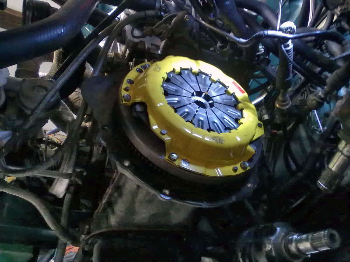

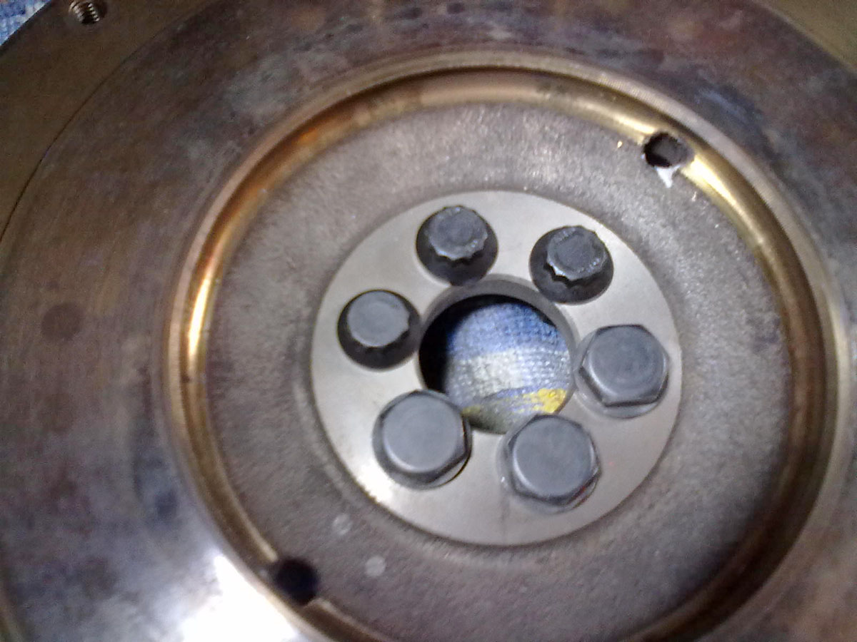

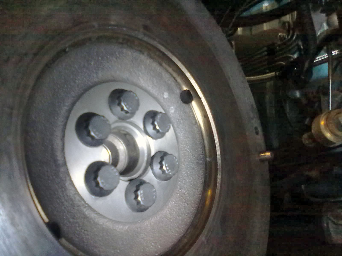

I finally got the ARP bolts (ARP# 203-2802), torqued them to 70ft/lbs (stock bolts 58ft/lbs) and this time with loctite....
ARP compared to stock bolts: ![]() ![]() New clutch... ![]() I got most stuff back together, just need to torque the transmission bolts and reinstall the IC piping. The clutch pedal is definitely stiffer compared to the Exedy Stage 2 but nothing to bad. |

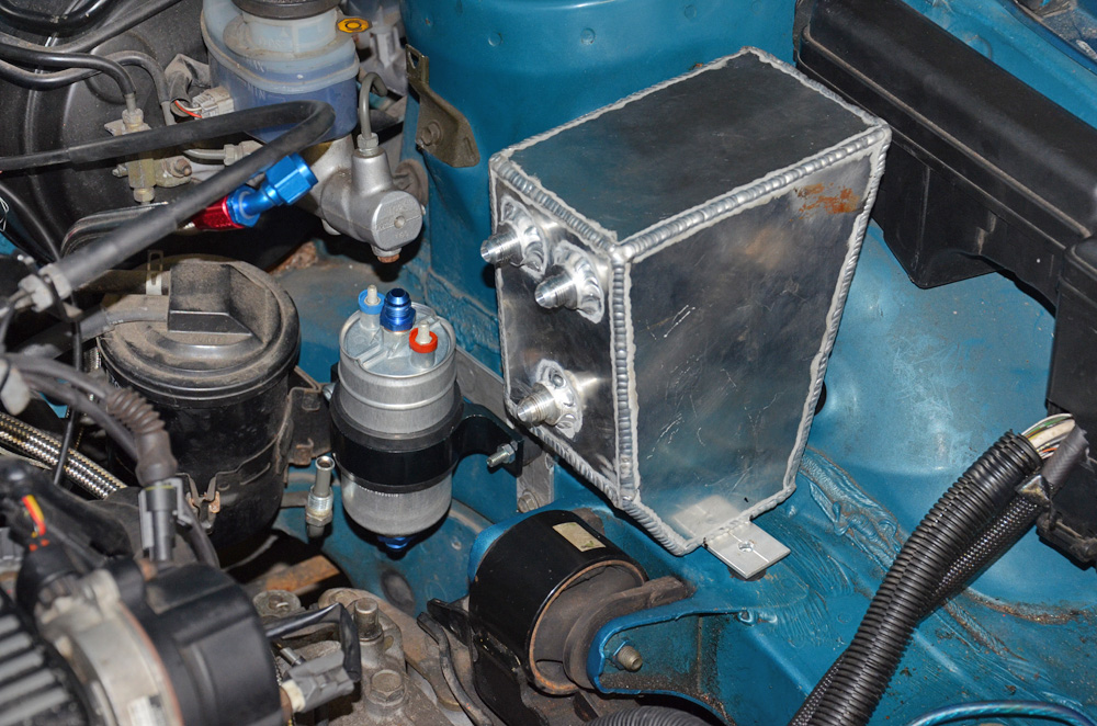

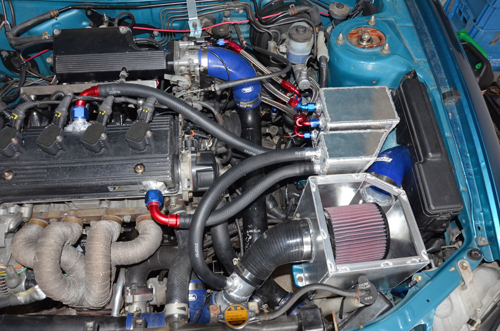

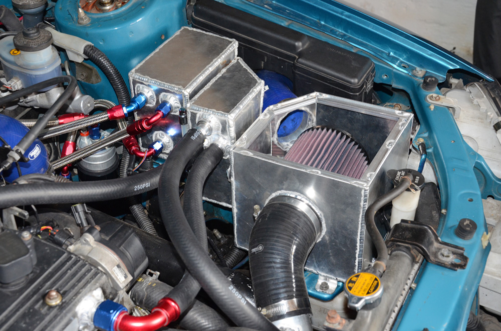

Long time since the last post... haven't done much on the car besides trying not to destroy something
![]() The only new things are some oil-/fuel catch tanks and a new air filter box, everything build from scratch. Since my Aeromotive Stealth intank pump died after just about 2-3.000km i put the old ST205 pump back in and let her fill the catch tank, from there an external Bosch 044 feeds the engine. The air filter box still needs a top cover since it's kinda illegal to run open air filters in germany .... but for now i leave it open, just love the sound ![]() |
![]() Enthusiast ![]() ![]() ![]() ![]() ![]() Joined Jul 12, '08 Currently Offline Reputation: 5 (100%) ![]() |
Thats some really nice welding. good work

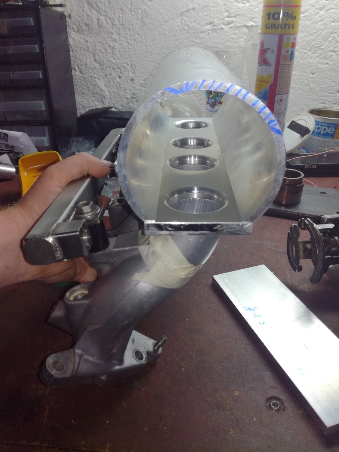

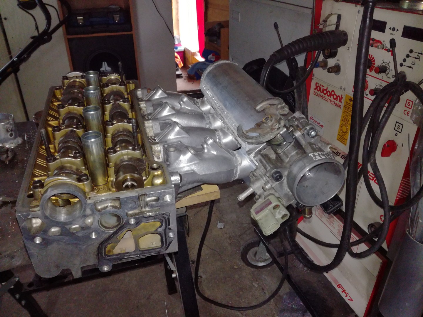

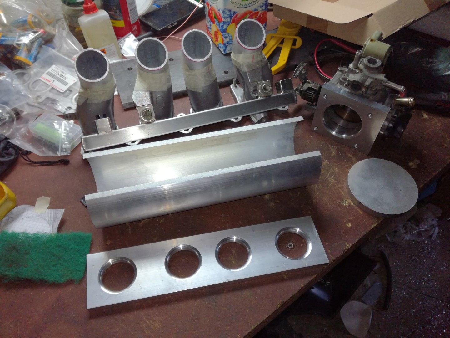

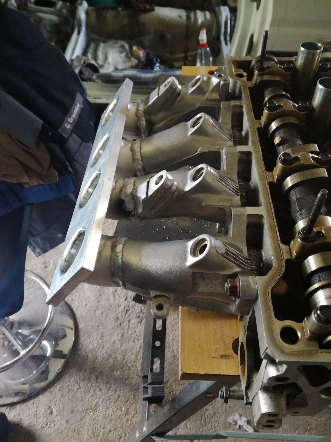

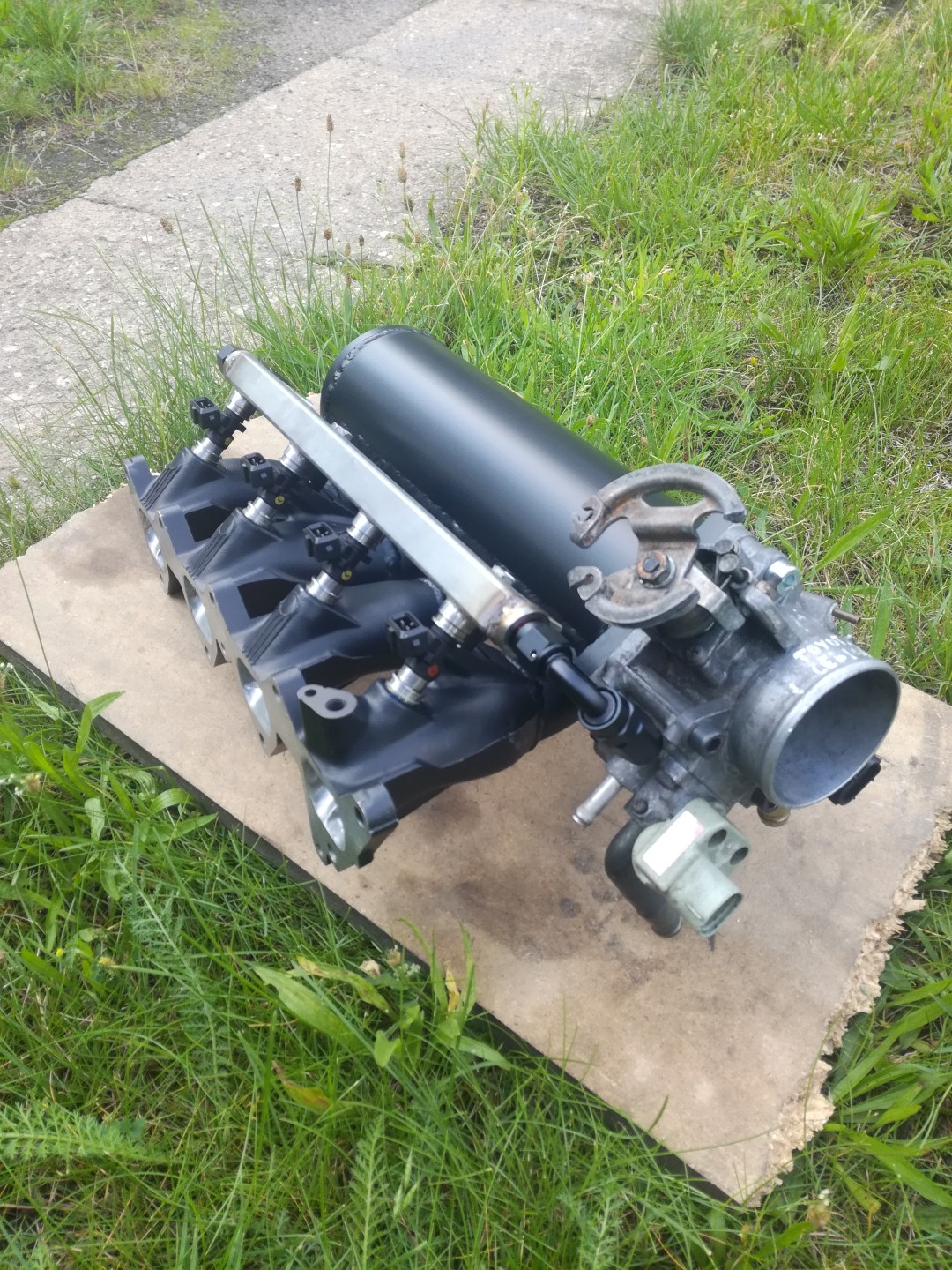

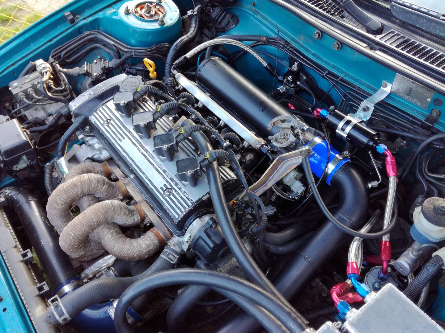

QUOTE Is the OEM oil pressure sender on the 7AFE also in the head? The pressure sender sits in the engine block next to the oil filter, but after over 1.000 miles i got no problem with the head so i think there's still enough oil pressure ![]() With the new cams in, the engine felt way better in higher rpms, revved pretty quick to 6500 rpm but still wasn't happy above that. The cams should be aggressive enough to rev way past 7000 without a problem so there must be something preventing a good flow. So i started building a new intake using a ST185 throttle body, here are some pics: ![]() ![]() ![]() ![]() ![]() ![]() ![]() And a short video of a 3rd gear pull, rev limiter is set at 7700rpm: https://www.youtube.com/watch?v=WRI1ZIktgAU The engine feels a little bit dull mid range since i lost some torque but it revs like crazy considering it's a 7A ![]() |

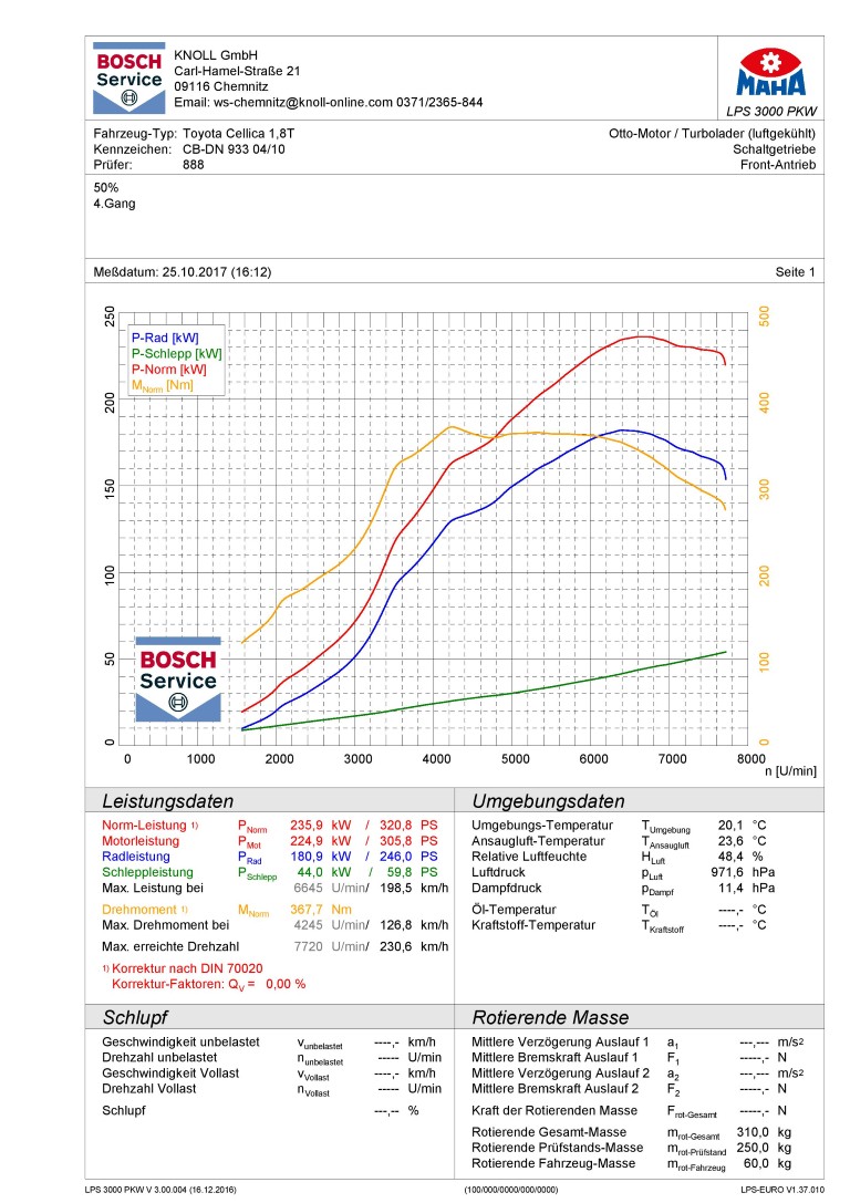

but great build. its so unique. are you still running that cold air box set up with new intake manifold?? Thanks ![]() The car finally was on a dyno and i'm very happy with the result, very nice torque curve and some good power regarding the old T28 turbo 1,1bar - 16psi ![]() And a short 100-200km/h video '94 Celica ST Turbo 100-200km/h |

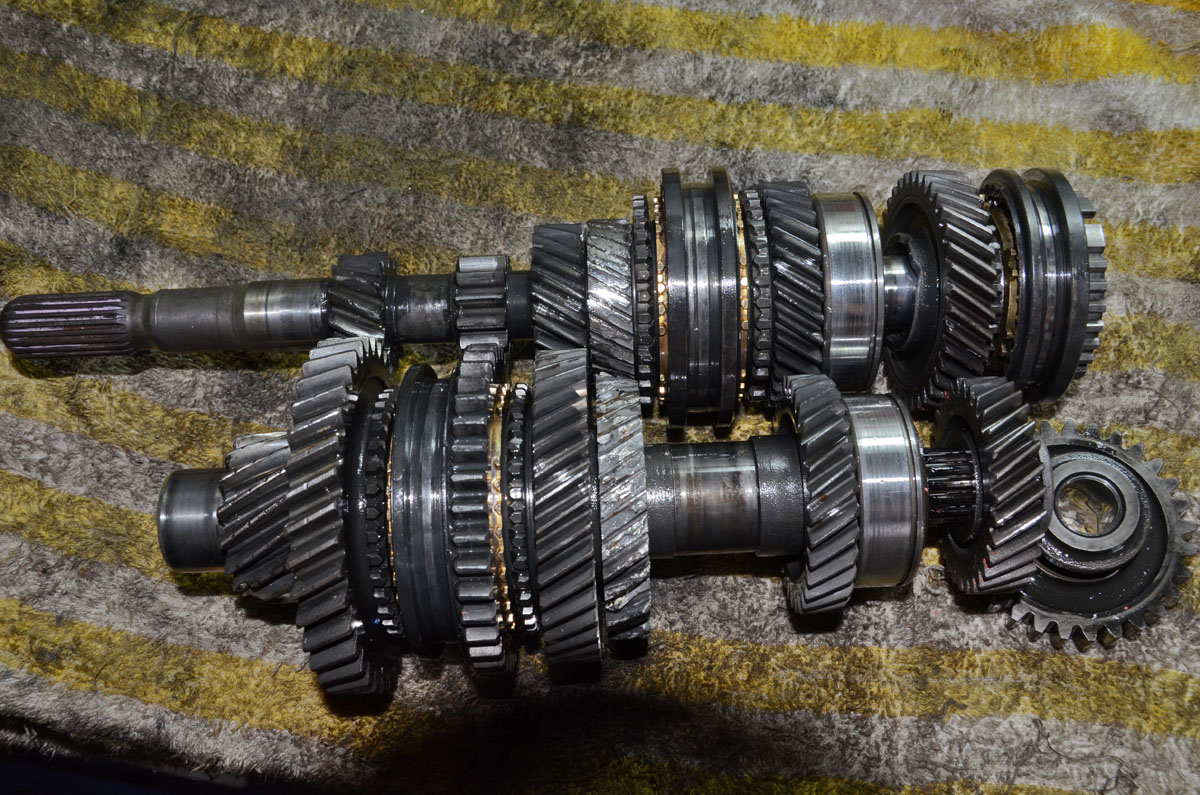

Quite some time since my last post and a lot has been done to my Celica, the car was running really good with the 2017 setup but i couldnīt get any more out of the old T28 so in 2019 i decided to go with a new turbo. I planned to get an EFR for some time but i would have been a lot work to make it fit, so i decided to stay with Garrett and got me a GTX2860R GenII and it definitely was the best decision... awesome turbo and the sound is amazing
![]() Of course the C52 didnīt like it that much... i kept boost in 3. gear at about 16psi and raised it in 4. and 5. to about 21psi but i still managed to rip the 3rd gear appart just like my old transmission... so i started to search something else that will hold some power... of course a E58 was the way to go but impossible to get in germany, i luckily found one in Australia and he even shipped it to Germany. Meanwhile i put in another C52 so in can drive and raised the boost in 4. and 5. even more to about 26psi and barely used the 3rd gear at all ![]() I took the E58 apart to see what i got and was a little disappointed regarding the size of the gears, of course they are stronger than the C52 ones but i was hoping for something more trustworthy ![]() ![]() Then i got the idea of mating a E154 ST205 transmission to the E58 bell housing wich should work in theory.... i found a E154f for even half the price the E58 cost me, took it apart and eveything was looking perfect, the gears are WAY stronger and should hold way more than my 7A will ever produce... ![]() ![]() A nice LSD shouldnīt be missing in a build like this... ![]() The mounts on the transmission had to be reworked to make all this fit but that wasnīt to much trouble, the clutch and axles were much more of a problem.... at first i tried to get a new clutch disc from ACT for my XTSS but they didnīt respond to me, so i contacted clutchmasters and they made me a custom clutch to fit the E154 spline, itīs a FX350 so still very daily drivable and holds quite some torque.. As for the axles i planned to get some custom made but that would have cost me a fortune here in Germany so i found a set of AW11 SC axles in the US.. not cheap either but it was the right decision, the outer joints even fit the AT200 hub i just had to fit ABS rings on them ... then i had the get some spacers for the inner joints made since the axles where a bit to short but it worked perfect in the end. Other things i changed are the PCV catch can and the air filter housing, i was trying to fit a filter as big as possible and ended with a Lexus ISF filter. I got some new gauge faces made to fit the engine better, rev limiter is set at 8100rpm. ![]() Next step this year is a new intake manifold with slightly shorter runners with bigger diameter and a much bigger plenum. And iīm building a new short block since the engine is blowing gas in the cooling system, at first i thought itīs the old cracked head so i build a new one last winter... but that didnīt fix the problem, even ARP head studs werenīt enough till i noticed that the deck was not flat. I wasnīt on a dyno yet but the engine should make about 400-420bhp, maybe 340-350whp. This post has been edited by Hafkai: Aug 1, 2020 - 5:09 AM |
