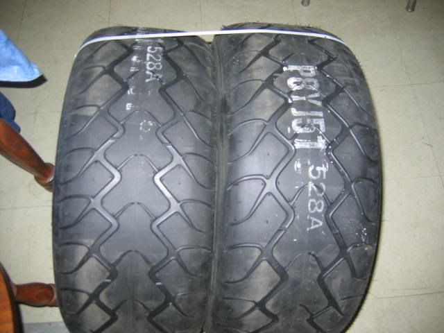

so yea...wheelspin all thru 1st and 2nd gear makes for a cool show for your friends...but super slow times at the track.
so, with that in mind (and the aweful though of ripping thru a set of michelins @ 175$ea..) i went ahead and ordered these:
yup, BFG's wink.gif 225/50/15 smile.gif

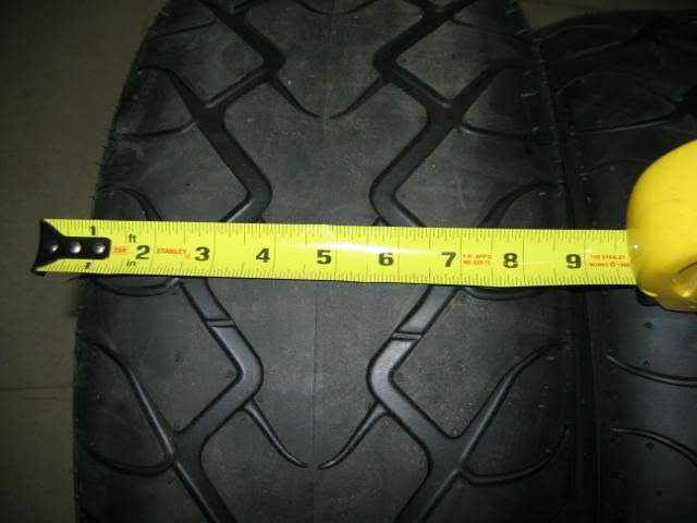

contact patch is a tiny bit over 9"
that alone should have a nice effect on traction, never mind the nice sticky compound. biggrin.gif

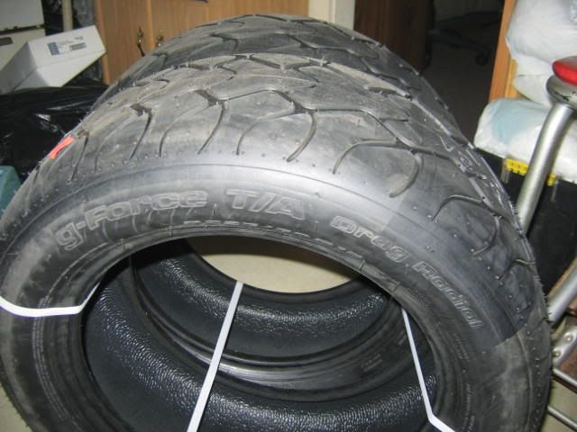

a couple more of the tread pattern, and sidewall.
i figure if hyde can run 1.4 60ft. times with them, i should at least be able to improve traction somewhatlol
if all goes as planned, i'll be seeing what the 5SFTE can do with TRACTION @ englishtown on the 18th
ill be installing them on a set of stockers, and starting them @ ~20psi, lowering by a lb or 2 each run, till the 60's dont improve anymore.

they will be mounted on stock 15X7 rims.
the tires are made to fit 6-8" rims.
