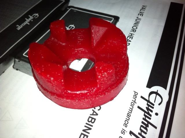

- - lagos   QUOTEQuality supervisor for the Epiphone division....   Sep 4, 2006 - 11:35 PM

- - 95celgt   so there's an auto mount in my 3sgte celi...   Sep 4, 2006 - 11:46 PM
- - lagos   QUOTE(95celgt @ Sep 5, 2006 - 12:46 ...   Sep 4, 2006 - 11:48 PM
