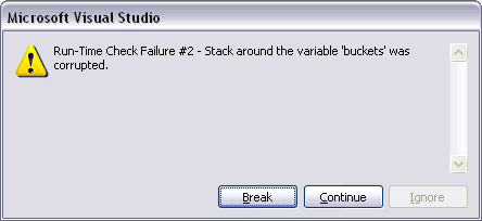

I've been writing a program for class and was getting strange errors,
so I went through everything and eventually simplified it down to this super-simple program:

Sounds simple, right? Create a 10 row, 5 column 2-dimensional array filled with zeroes, right?
The problem is that my output is this:
Anyone have any idea as to what could be going on? If I manually fill the array with zeroes using two for loops, I get the correct output, but when the program tries to exit after I enter a character, I get this error:
Any of you programmers out there have any ideas?
Attached Image Attached Image

- - phonex98   I agree with Jon. Its been a while since ive done ...   Oct 12, 2006 - 8:37 AM
|- - Starcraftjunkie   x2. Initalize with the [10][5] and it should be f...   Oct 12, 2006 - 12:05 PM
- - phonex98   im pretty sure he's using the cin (input) as a...   Oct 12, 2006 - 9:38 AM
- - Coomer   Awesome...that worked. Thanks a ton guys.   Oct 12, 2006 - 12:17 PM
