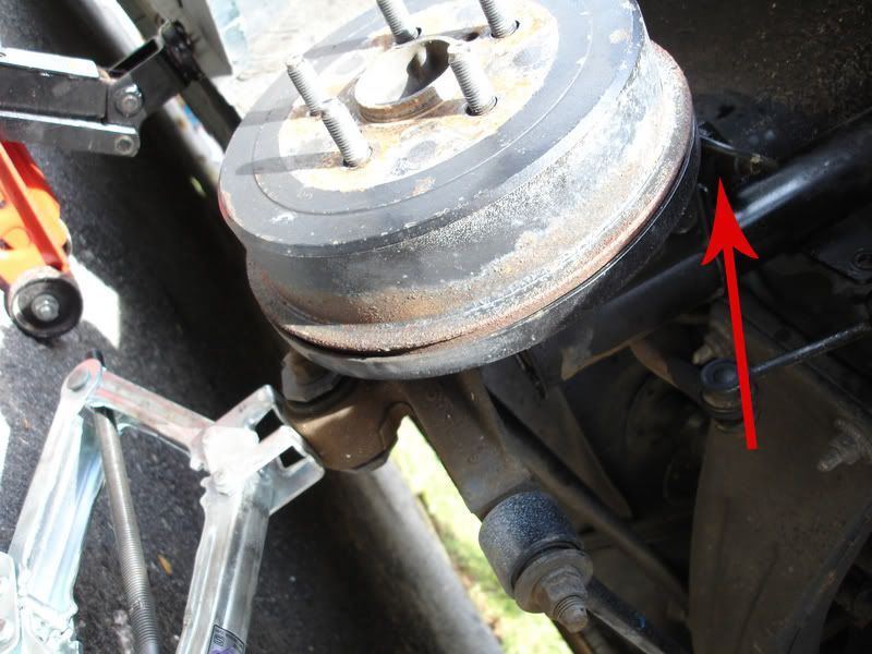

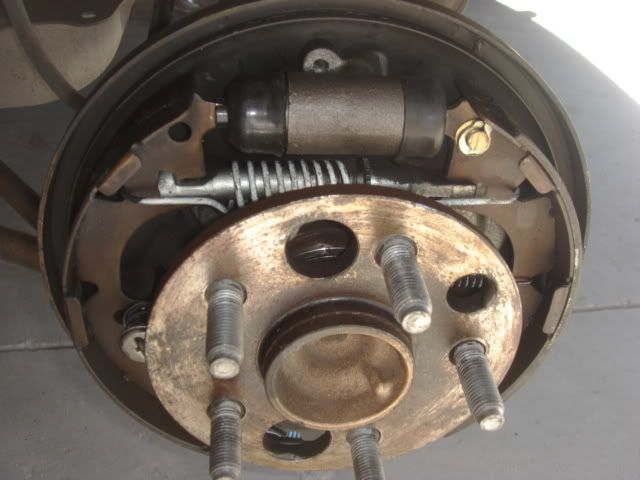

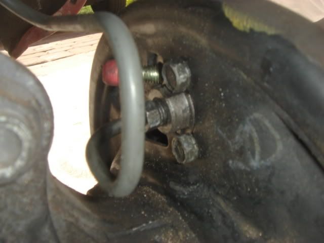

these pictures are from the sway bar end-link removal how-to so they aren't very specific but just so you get the idea of what your looking at and where...
when you take the wheel off look here...
you should see this...
if thats ok look here...
if thats all ok look at the back of the drum or caliper to see if its leaking from somewhere back there. I don't have a picture of the bleeder or the brake line connection to the drum or caliper. like Batman said just take a picture of where its leaking and post it up. smile.gif
