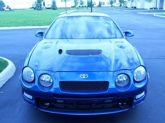

actually i have a gt4 hood and bumber... what i meant was its just very hard to get the hood to sit perfectly between the fenders
this isn't the greatest pic, but maybe you'll see what i'm talking about

according to your picture, your hood doesnt look all that bad at all. i can see how there is a little more of a gap on the passanger side, but yea id go with the loosening the bolts and just tweaking it and closeing it again. an alternative would be moving the fenders in and out by loosening the bolts as well.

You need to adjust the fenders if you can, because of the front latch I dont think you can move the hood from side to side. In the back you might get away with it.
