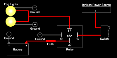

4. ok now for teh hard part, wiring........first run yoru wires inside the crash bar..and leave 2 single wires to reach to the fogs.....a black, and white wires are required to wire up to your fogs......on yoru fogs....teh black os always the neg/ground wire...and teh otehr color is pos/power......theres a wireless remote control module...mount it anywhere thats secure...ive mount it insdie teh crash bar along with all teh excess wiring......ok now yoru almost done......wire teh red wire to a power source.....ive opt to wire it to the ign fuse in teh fuse panel inside teh car...taht way when i turn the car on, i turn the fogs on with teh remote..and when i turn off teh car teh fogs shut off too.....or u can mount the red wire to the + side of the battery and u can turn it on/off regardless if teh engine is runnign or not.....all teh other black wires should go to yoru chassis ground or to your - side of yoru battery.....check the fuse making sure theres no broken diodes....and your set..
or you can follow how batman wired his fogs if u dont wanna wire it with the wireless remote controlled switch....(which i think is way better than my method)

Is there a better diagram to wire your fogs like for positive, ground, battery, and straight to a switch? Thats how mine is run. Batmans own is a good diagram but it incorporates a relay and I get confused where the two red wires come from the switch.
