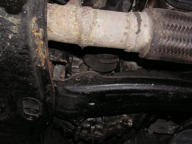

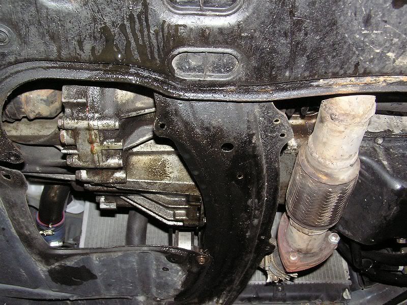

Folks look what I have found after lifting my car:
main leak point was place where is transition connected to half shaft (some joint or something):
for better orientation once again with comments:
here another picture from different angle:
what do you think it should be? I have some theories:
- bad balance gear (differential gearing) or it's bearing
- bad axle joint... it self or some part like some seal or ring cup... I don't know
- bad half shaft (half axle)
what do you thing? anyone seen this before? Wanna more pics?
thanks for any advice...
p.s.: sorry for multiple names of parts, I'm not sure which one is right (or better) for that... kindasad.gif

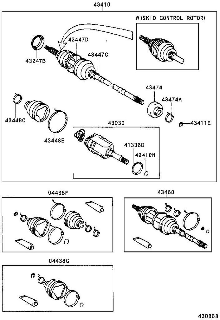

RH drive shaft EPC pic:
front axle holding EPC pic:

seems like the snap ring inside the axel is missing.
That axel (or joint) should be locked into the transmission and should not beable to move in and out at all.
you might as well replace the seal while your in there.
If that doesn't fix it, it might be something wrong inside the transmission.
post Apr 16, 2007 - 11:26 AM
doGGy
Joined Oct 28, '02
From Europe, Lithuania
QUOTE(Hanyo @ Apr 16, 2007 - 2:27 AM) [snapback]547188[/snapback]
Bingo. Might be that locking ring on the end of the axle is missing, and once the axle is loose - oil will leak like crazy. Once you take your axle out - be sure to check the seal in the tranny, and replace it.

could you confirm which parts should I order?
- 43410N (ring, hole snap)
- 04438G (front drive shaft inboard joint boot kit)

The passenger side axle doesn't have a snap ring on the FWD. The axle is held in place by the carrier bearing that is bolted to the bracket on the block.
Anytime the axle is pulled away from the seal it will leak. The carrier bearing should not allow the axle to move out of the transmision. If it's leaking while the axle is in place you should replace the axle seal... It's labeled 23247B in your EPC screenshot.

RESULTS:
only that part with number 43410N (ring, hole snap) in this picture was broken...

Yes it was snap ring from passenger side. There really is also mandatory snap ring (you can find it in EPC as well)
