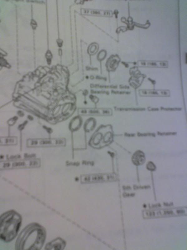

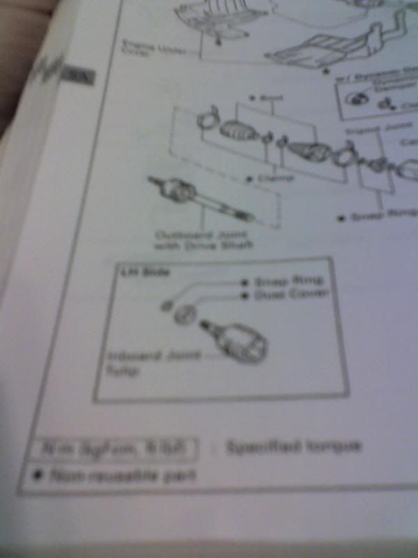

My first guess is, at the end of the axle is a snap ring which is supposed to be replaced when re-installing the axle. I didn't replace this ring as I didn't know it needed to be replaced. I took some pictures of my manual to show what I mean if that isn't clear:
the next thing I think it could possibly be is the O-ring for the differential case bearing retainer. Basically where the axle connects to the transaxle is this piece with 6 bolts going into it. I had a hard time removing the axle and I figured those bolts needed to come out. So I had removed them and had even pried on it! There is an O-ring under it that is a non-reusable part that I think could possibly cause the leak. here's a pic (the letters are blurry, but you can still somewhat read it. it's the O-ring underneath the "differential side bearing retainer", the diamond, which just looks like a blob in this picture, indicates it's a non-reusable part)

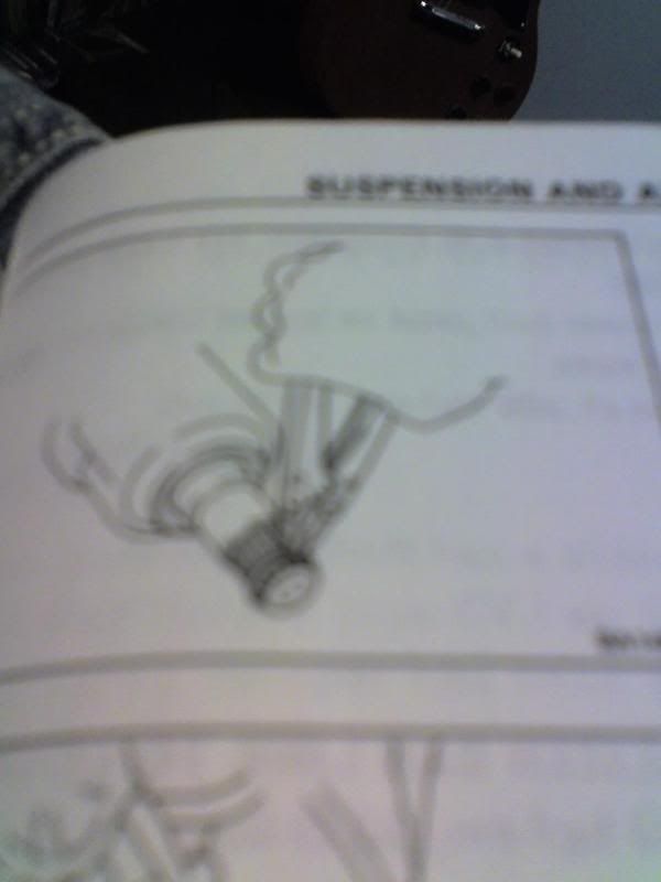

Lastly, I guess there is an oil seal inside the same bearing retainer. This seems the most likely culprit to me. here's two pics showing the pictures and the text next to them regarding this oil seal:
