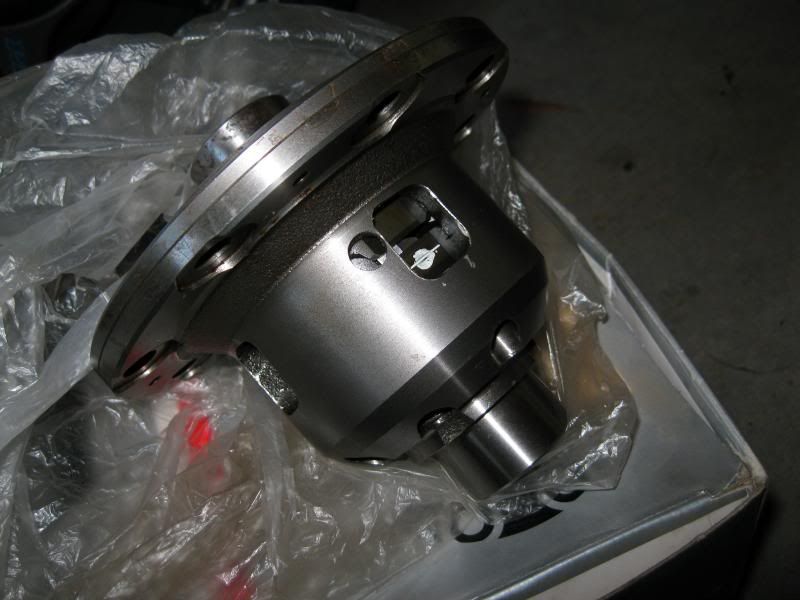

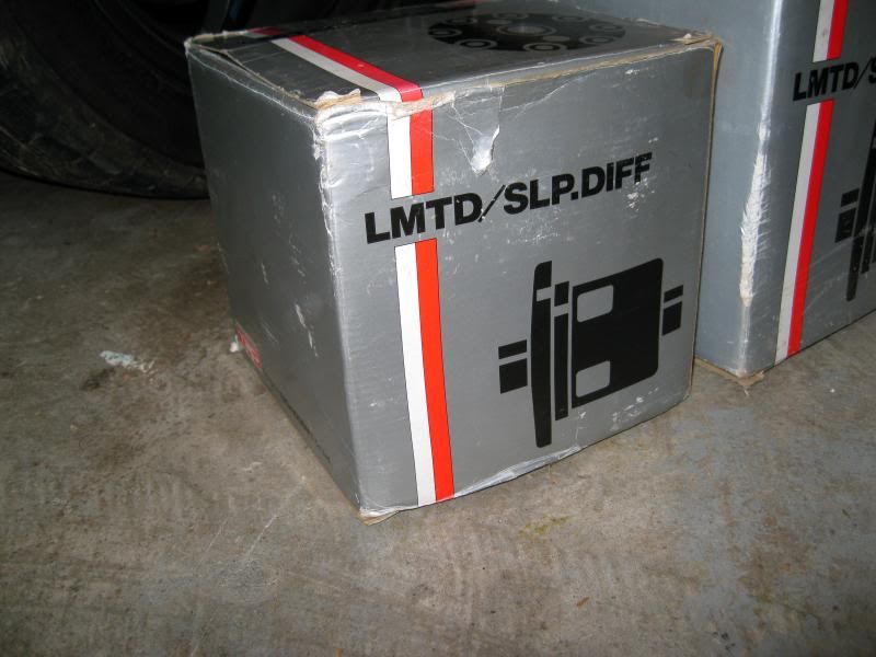

I came across a guy locally in NZ selling this, a new/unused TRD mechanical LSD, it at a good price, if I hadn't have come across this I would have gone for the S54-6D, but people here have started to figure out which have the lsd and has put the price up/ harder to find a good one, plus add in shipping cost etc
anyway pictures
It has the part number 41301-ST803, but I know the part number was updated to 41301-ST804. And incase your wondering the other TRD LSD box is from my brothers old supra.

Awesome!!! Is that the cluth type? I literally forgot all the knowledge I had gathered about LSD only a couple months after I got mine haha

thanks, pretty sure its clutch type, its not the easiest thing to have a look at the insides of.
the info sheet it came with is a bit tricky for me to understand aswell. And its a bit tricky searching info about it.
haha wont be going in anytime soon though, will go in when its time to replace the clutch.

ah I got a closer look finally (rather than looking at it on my phone) It seems to be a clutch type for sure. Awesome it came in the original packaging too!

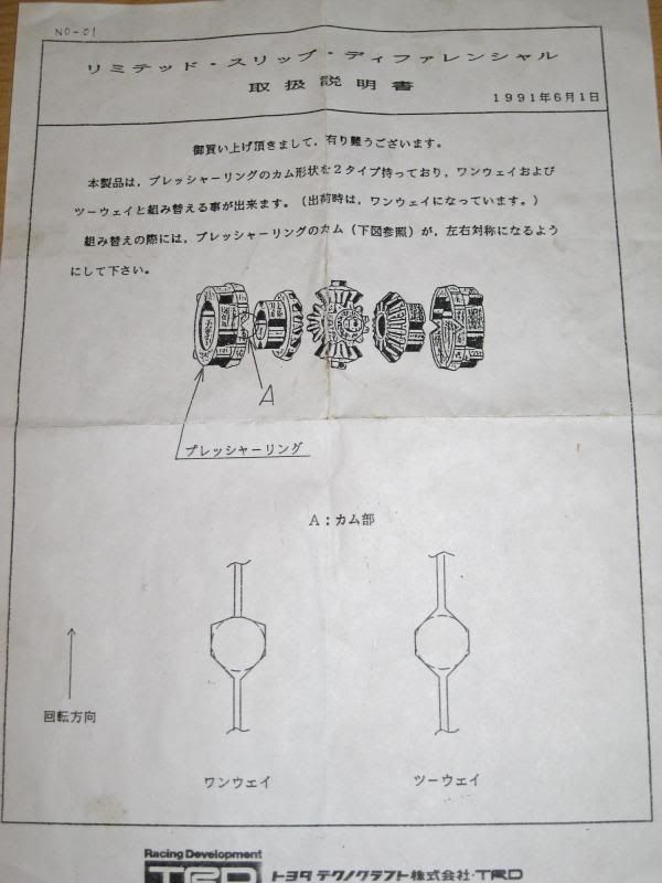

is the sheet all in japanese? haha

It's been awhile now since I've studied Japanese at high school, the kanji characters don't help...
there's a break-a-part diagram, which goes onto different options, which I'm guessing is to convert from 1.5way to 2 way - like it says on the trd website
Adding a photo of it now...

the top stock picture makes it look to be a clutch type. the bottom paper that came with it seems to be a helical, or maybe it just omitted the clutch "plates" from the diagram

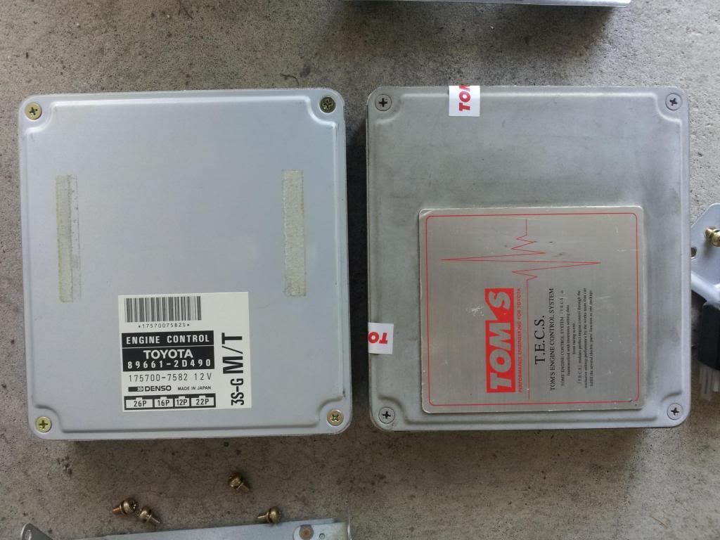

Got back today to install the recently purchased ecu, Tom's TECS II ECU for ST202 3S-GE
Wasn't too difficult apart from the 2 nuts on the driver's side due to the foot rest.
old vs new
Started up first go, no codes or issues, gave it a few revs, sounds good. Booked in on Thursday for a dyno power run and air/ fuel ratio check to ensure its all safe, it should be pretty good/safe but just want that reassurance.

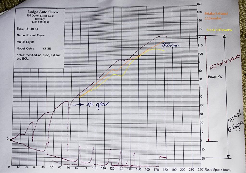

Dyno & A/F check today
Everything check out great.
It sounds a lot more aggressive when the ACIS switches over, very smooth idle.
A gain of 10 KW throughout the entire rev range.
so:
@ Wheels
123Kw = 165HP
@ Engine
141Kw= 189HP
my first dyno:
@ Wheels
107kW =145HP
@ Engine
133kW = 178HP
post Oct 30, 2013 - 10:35 PM

A good comparison over all 3 dyno's. (Went to the same place each time)

Nice, lambda looks good. Did they listen for knock? or able to record ignition timing? or not so much in the way of datalogging?
if that graph was of a higher resolution, such as a dynapack printout might be able to check for points where ignition has been pulled to give you an indication of any knock.
