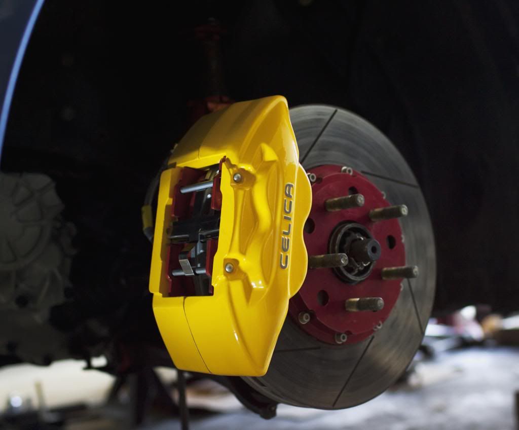

thanks guys! I hope one they are all together and connected that my wheels wont lock up with these!
I dont have much weight behind them!

QUOTE (Tigawoods @ Apr 9, 2013 - 5:29 AM) *
yup they are. No they dont need spacers, behind them.
The brake lines I got are for a TT Supra. With Goodridge, the lines dont have the little pin that keeps the line in place on the caliper. Ive read that this is a common thing with their lines, but that people have had no problem with them
No problem! I think I have filled the last few pages with some of the details of the swap, and Culpable has a thread with a bunch of info as well
So let me see if im understanding this correctly. I can go to my local autozone pick up a set of 97 n/a supra rotors and they'll slide right on to my hubs like my celica rotors? If not, how will an st185 rotor hold up? Im asking cuz Im having issues tracking rotos for my 205 calipers and I dont wanna have to drill 5x100 spaced holes just to make them fit. Just want to buy set slide them on with ease and be done with it.
This post has been edited by Lil-Joe101: Apr 16, 2013 - 2:07 AM
post Apr 16, 2013 - 6:30 AM
Tigawoods
Joined Dec 22, '06
From Columbia, MD
nope. you have to redrill those rotors.
Im not sure what stock rotors will fit, I was talking with Fate and he had a few options that he was going to try ( i forget what they were)
but you could also call up brembo and possibly give them the specs (300mm dia/ width ?? i need to remeasure i forgot!!/ hat size and hub bore) for the rotors and see if they have something that can fit or if they can make one.
itll probably be cheaper to just re-drill supra rotors haha.
And the ST205 rotors will bolt right up to the rears, hubs are the same size too!

post Apr 16, 2013 - 8:11 PM
cannot tell from pic, did u leave them dust shields?
post Apr 16, 2013 - 8:21 PM
Tigawoods
Joined Dec 22, '06
From Columbia, MD
these hubs dont have the dust shield. But Im switching hubs and the ones I will be using has them. Which is good because I want to adapt them for brake ducting

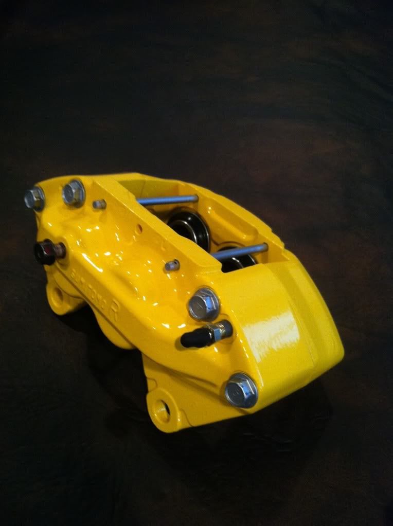

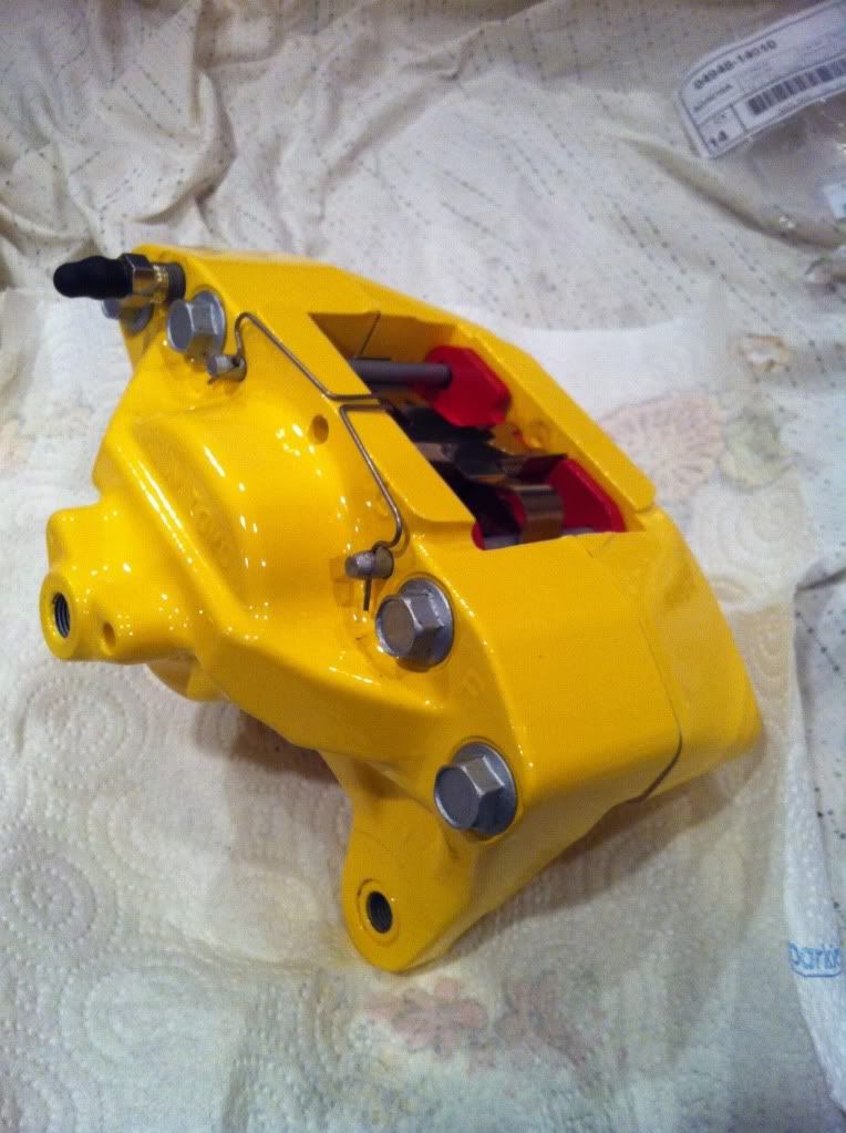

rears are on but I dont have any pictures.
hope to get the car back on the road next monday
here are some cell pics I took just to document some things.
spare hubs I refinished, took them off and Im using my original hubs. I prefer having brake dust shields
some more assembled caliper pics. Itll be nice to have pics of them while they are clean...before the brake dust storm comes in
rears
This post has been edited by Tigawoods: May 13, 2013 - 10:11 PM
