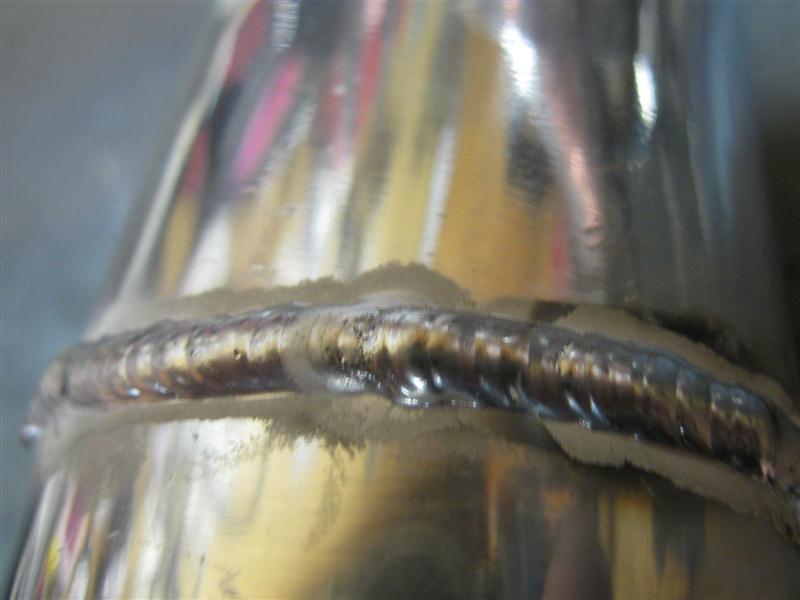

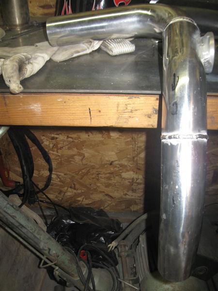

just waiting on one more bend to arrive, to finish the last peice of the cold pipe, now that i have some experience with those ebay piping kits, i know why people (the ones who weld them) complain about them.
the quality of the tubing is horrible.
pre-polished pipes suck to weld on, there is SO much contaimination ground into the pipes from the polishing process, and you can never really get it all out.
start welding, doing fine, and without warning, it all goes to crap as you pull out all the contaminates in the aluminum, and it kills the puddle.
a couple pics of the last section of the cold pipe, cam took the rest of the pipes and IC home so he could clean them up yesterday.
you can see the contaminates sitting on top of the bead in this pic:
hopfully the last peice will be in tommorow, and all i will have to do is weld up the last bend, and weld a couple of mounting tabs to support the tubes.
