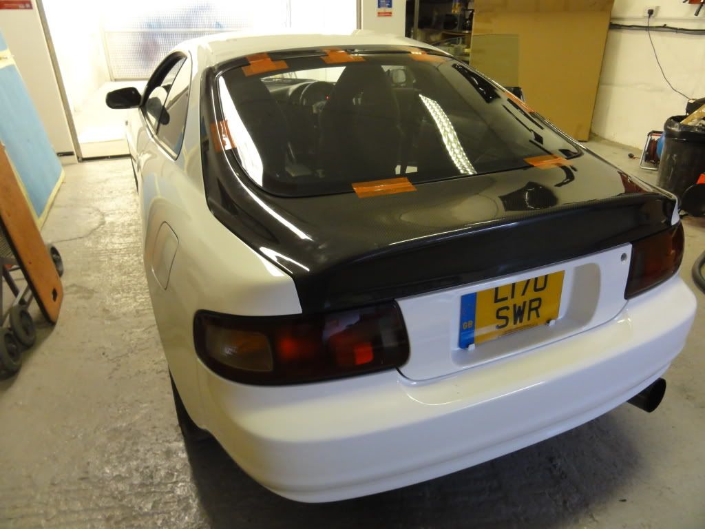

I've disconnected my 3rd boot light and don't want it. Now I have a blown bulb indicator on my dash. What can I do in terms of wiring something in to fool the car thinking there is a light there?

Reason why I don't want a boot light is becasue I have a carbon boot which is flushed and looks so much better.
