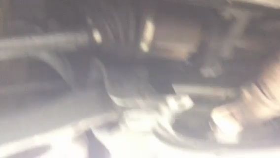

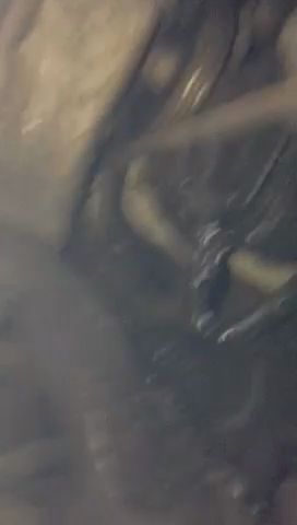

- - Malhar95   I'm sorry but this is what I could do rite now...   Sep 30, 2012 - 6:24 PM
- - Special_Edy   Yes the passengerside cv axle is bad, order a new ...   Sep 30, 2012 - 7:58 PM
