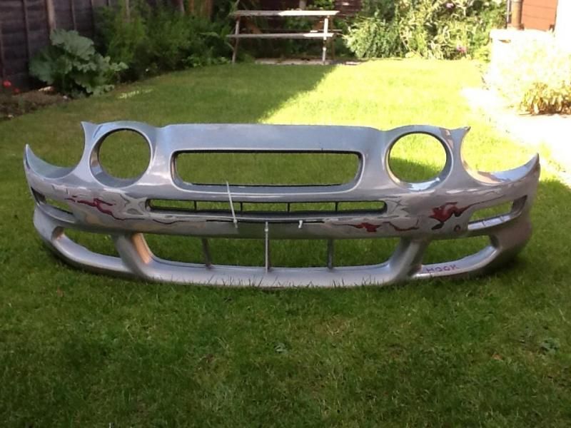

Finally got this glued together, if you want to have a go yourself, this is how I did it.
Once you have cut the two halves of the bumper and matched them up you need to start by drilling a series of holes about an inch from the join about three or four inches apart.
I then zip tied the two ends together and then started zip tying towards the middle, as I went I put the wire mesh on the back
The front
The back before the glue is applied
And with the glue applied and pressed into all the mesh and holes
There is more to do but I need to let the glue fully cure overnight at least. I will then add a bit more glue into the bits I missed and fill in any holes in the join.

QUOTE (Nial @ Aug 3, 2014 - 11:34 AM) *
A bit of scratch fabrication today, it's still a bit rough and needs finishing off, but it's a...........well, can you guess what it is :confuse: :confuse: :confuse:
Short answer... no tongue.gif My guesses would be cooling duct for something, but very narrow, or replacement support for something with room to run small pipes around.
Nice work on the bumper too, hopefully it finishes up well for you this time smile.gif
